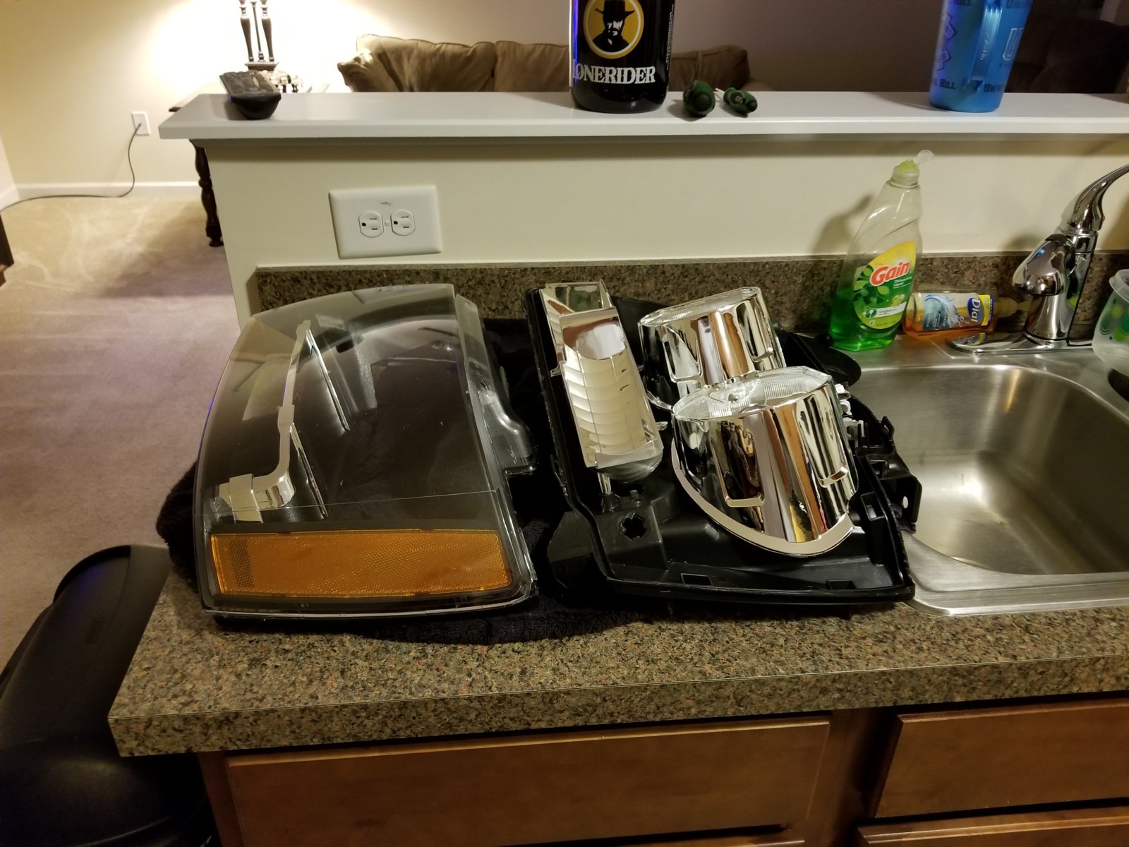

Thanks for the encouragement and replies guys. I had a couple beers to cool the nerves, and finally got the first one apart. I put this light in for 20 minutes, then gently pried around for 5 minutes.....then back in the oven for 5 minutes. Repeated until they were apart, which took 3-4 more rotations.
