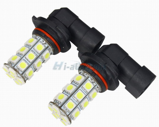

Well,I am thinking about headlights. Lots of people think I should use the HID lights. I am not really enthused about those as all the extra parts such as the ballasts, and the fact that they have to "warm up".
My Tahoe currently has HIR bulbs in it, which to me seem to be really bright, and I am actually happy with them...However...
We recently took delivery of 5 new electric hybrid buses at work, and they have LED headlights in them. Very, very nice bulbs...and very small...
I looked on EBAY and these bulbs seems like a good choice. anyone running them yet?
9006 lo beam
9005 hi beam
Just was wondering...

yeah the source of the light is all messed up with those plug in LEDs.
It's best to stick with what you have or do a projector retrofit.

The LEDs in those busses is different from the crap on eBay.
This.
What you're seeing on those buses are OE led modules similar to these http://www.jwspeaker.com/products/headlights/model-90-90mm-led-headlights or these http://www.hella.com/MicroSite/soe/sites/default/files/J00353_KI_90mm_Premium_GB.pdf, not available as a PnP application. As you can see in the drawings the heatsinks behind the lenses are huge relative to the front surface area. That's because that's what's needed to dissipate the heat that led chips bright enough for usable lights generate. The little PnP bulbs you linked don't have enough lumens for a functional low beam, and if they did they would project wrong in reflectors, and would fry themselves rather quickly.
