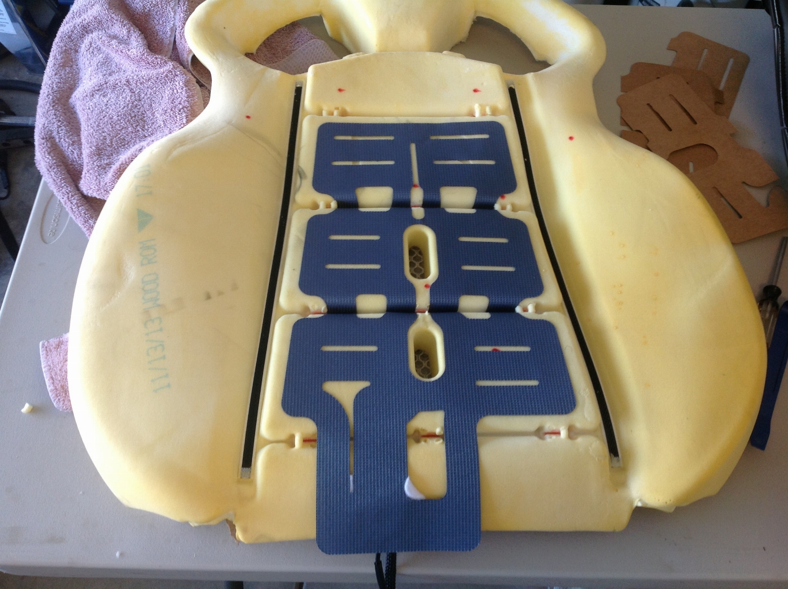

Aftermarket cooled seats are set up to run the TED in both directions to heat and cool. I can't get a definitive answer on how GM seats are heated when they have the cooled seat option. The C7 Vette uses a standard heated element with cut outs for the cooled TED air.
It took a little digging. The Escalade uses the TED for cooling only.
The NNBS (07-14) uses conventional heated seat mats NOT the TED.
The
Escalade would have seat heating elements similar to the one above for the C7. Check out the thread below on diagnosing an 09 Escalade heated / cooled seat.
2009 Escalade driver seat heating and cooling not working
Correction… 07-10 uses TED for cooling and heating. In 2011 vented seats were the only option with resistance mat heaters. 2011 also saw the airbags integrated into the seats.
The NNBS (07-14) uses conventional heated seat mats NOT the TED after 2011.
