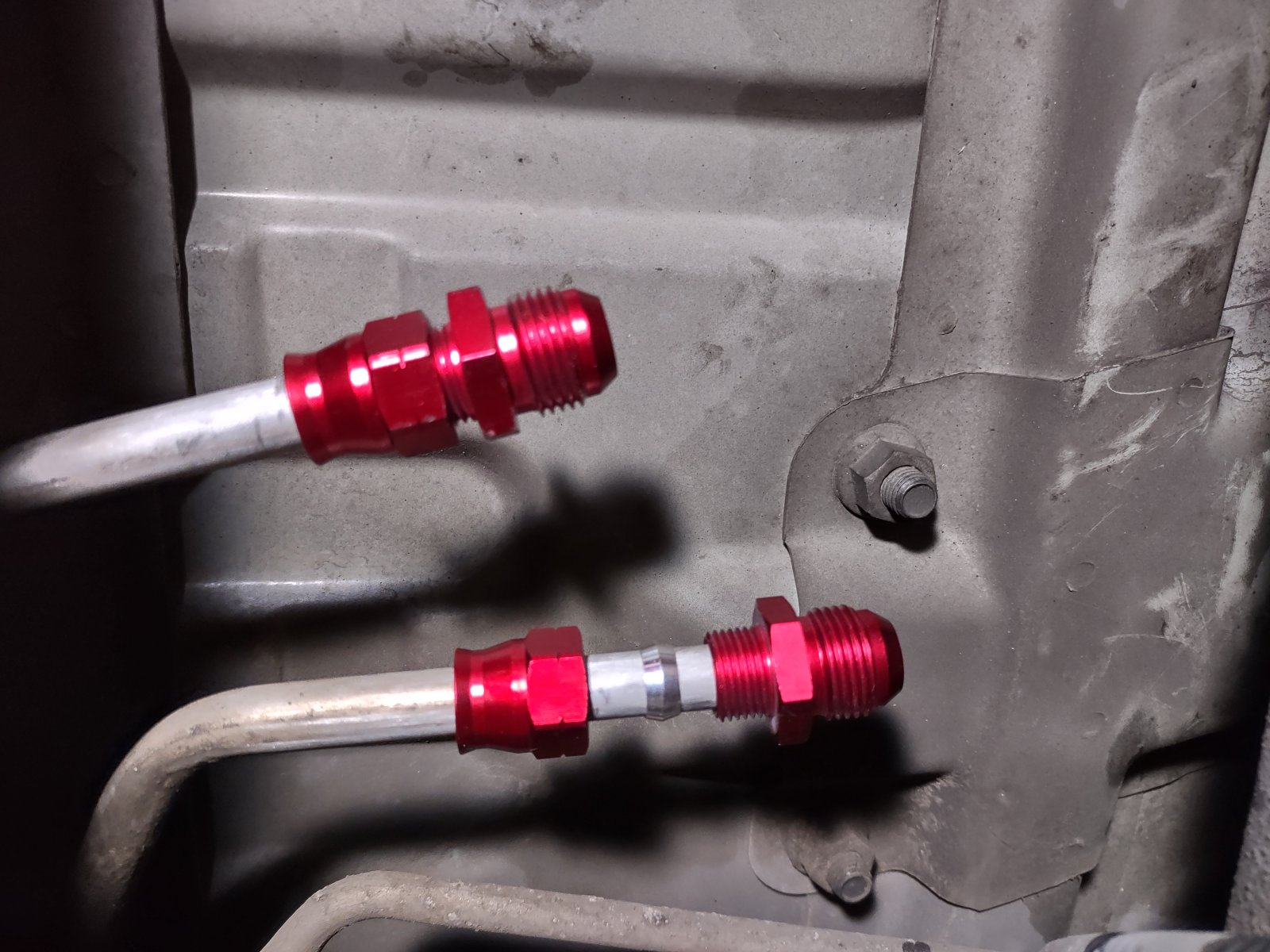

I'm embarrassed I even had to ask:rolleyes:. That black ring is rubber from the factory connector and was so hard, I thought it was metal. Both pieces came off leaving the expected single barb.
I will say after doing one line, I would only go the route that @rdezs used and buy the AN fittings. It's a royal PITA to cut the crimp off through a tiny opening in the frame and much easier to cut the tubing shorter where it's exposed. I stopped after doing the leaky line and will order up some AN fittings for line #2.

That looks like a remnant of the old quick disconnect fitting that came apart. It should be plastic. If you take a pair of pliers or vice grips off center, carefully try to fracture the plastic and then you can peel it off. You should be left with a slight aluminum ridge.

Ah.... Your earlier addition to your post just appeared after I responded. Yeah, there's not a whole lot of room to be cutting the crimp off. After dropping the spare tire, a small pipe cutter worked quite easily.
One of these works perfectly:

If you go the route I did with a compression fitting on the original pipe, that pipe is 1/2 inch outside diameter.
After dropping the spare tire, here's what you're looking at. The two crimped hoses closest to the camera that look like they've been sleeping are the heater hoses. You can carefully cut the crimps off, and there's a hose barb under there. Or simply cut it off a little shorter and have more room to work with for future replacement.
This is all you need, in addition to 5/8 heater hose.... I used silicone heater hose for this.... And hose clamps of your choice. I prefer the oetiker clamps.

Scroll up aways, I think I listed all the parts a couple months ago. You basically dropped the spare tire to access the aluminum pipes, cut them and install a compression fitting where one end gives you a 5/8 heater hose barb. I went with silicon hoses with oetiker clamps, doubled up.
