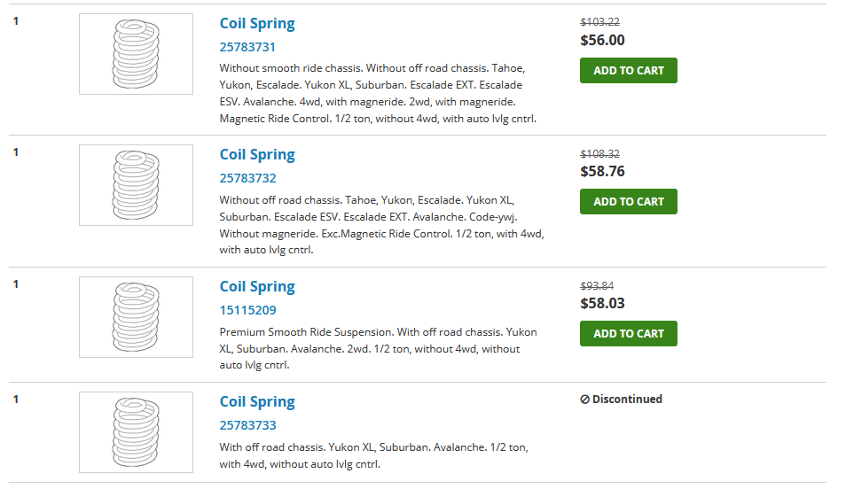

Trying to make sense of what shocks I have ...I have the ZW7 premium suspension that supposedly includes Nivomat self leveling shocks in the rear. ...my other option codes are 6XU and 7XU whatever those mean.
You'll want to put Air Lift Springs, 60769 in your rear coils to keep her from sagging under the additional weight.
You do not have Nivomat shocks, those ended with the GMT-800s.
We have essentially the same vehicle an configuration and my rear shocks are 25871227/540-435 and the springs are 25783733/45H2164. 6XU and 7XU are the codes for your front shocks. My front shocks are 20765171/540-460. My front springs are 25876861/45H0427.
You can look up your front shocks here using those codes and your VIN:
https://parts-catalog.acdelco.com/catalog/catalog_search.php

I'd rather not go the Air Lift route and just try and stiffen up the coils. If I bought new 45H2164 for the rear would that help over the current worn coils? The other option I was looking at was the Moog 81071 coils, I was going to try the 81069 HD coils but don't want the 2" lift that comes with those.
