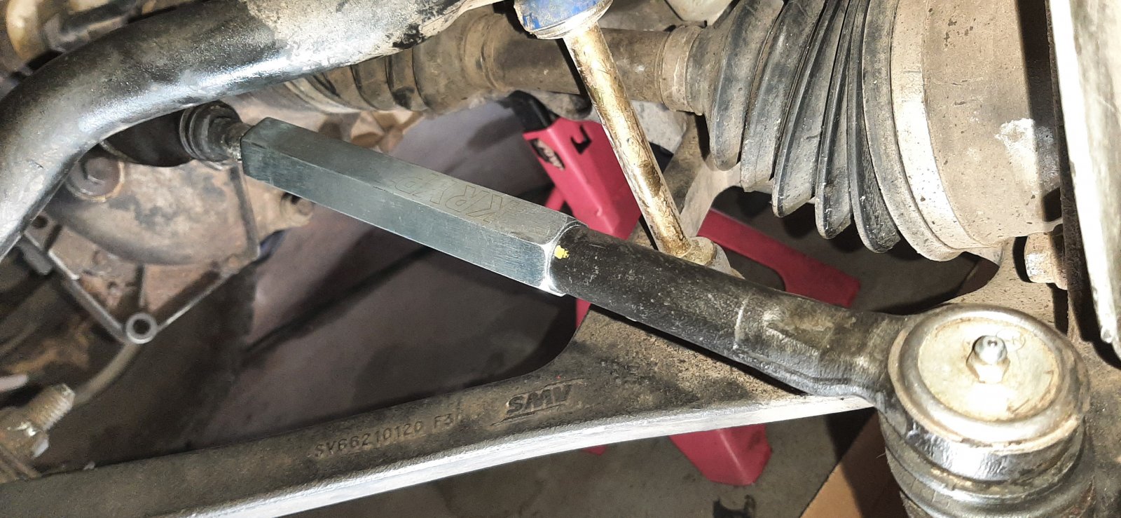

I drive on old forest roads a lot with my truck. I am curious, do they make a decent yet affordable heavy duty tie rod? I see a couple brands but they're around $300. Or do the HD trucks have better tie rods? My 2001 Z71 looks like they put pencils on for tie rods.
yea i tired of the match stick tie rods aswell so im doing alittle upgrading tie rod hhd.jpeg
