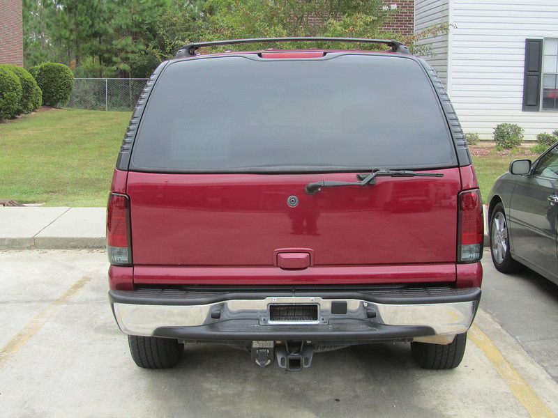

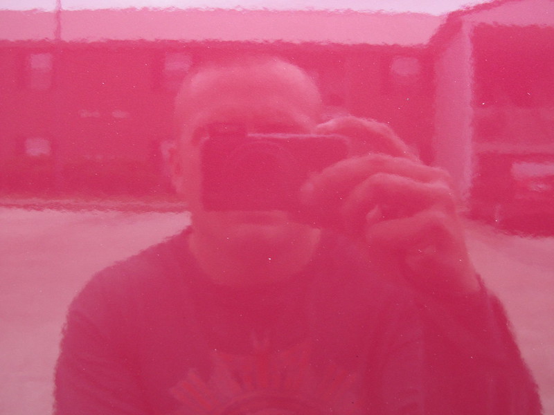

So i picked up a porter cable 7424 a couple weeks ago and finally got a good chance to use it.
Picked my wife up a 04 yukon 80k miles paint was in ruff shape and i think i did a pretty good job but i know with the right products i can get better results.
this is what i did.. and i would like some input of what will help me get more depth to the paint...
2 bucket wash with filter deal in the bottom of the bucket. wool mitt...
removed badges on the sides and rear, used 3m eraser to remove adhesive
removed silver pin stripe with 3m eraser
washed the truck again
clay bared everything
compound on 3.5" CCS orange pad to all windows ( removed all water spots and crap build up)
meguires scratch X and 3.5" orange ccs pad over ghosted pin stripes and emblems
moved up to 5.5" CCS orange pad with Pinnicle advanced swirl remover
http://www.autogeek.net/pin220.html
went to CCS white pad and pinnicle advanced finishing polish
http://www.autogeek.net/pin230.html
moved to CCS green 5.5" and meguires ulitimate liquid wax
Im hurting on WAX and no sealer...
The meguires ulitimate was kind of a last min. oh crap i dont have anything lets go to autozone because they are the only ones that cary anything above turtle wax....
Whats the consensus on here... what do you guys use for a buffer... ( i dont trust myself enough to jump into a highspeed buffer with flat pads yet...)
are there some more steps i can throw into the polishes???
i need a good wax... its hot here in gulfport ms. so i think a syntetic wax might do me better but i really have no preferance...
What do you guys recomend for sealers???
sorry no before pictures but it was bad... who ever owned this before i dont think waxed much the paint was very faded... not beat up (scratched or dented just faded bad...)

side note... i havent searched yet but i want to remove the roof rack to do a better job on the roof.... is there a gasket??? or what is underneath that mounting bracket???
