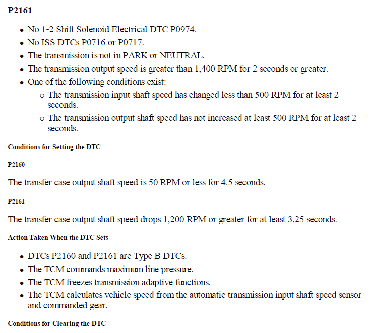

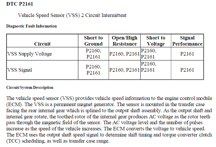

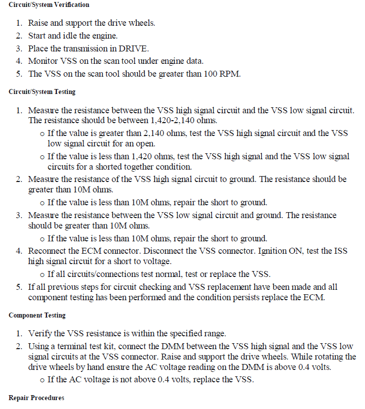

Did a scan and got the following code:
P2161 Vehicle Speed Sensor "B" Circuit Intermittent/Erratic/High
Does that mean the VSS needs replacing? If so can anyone share part no. And location? And is it something I can do myself (diy) or must take it to the dealer?

My first thought is that that code is related to your instruments cutting out, some kind of short. How old is the battery? What is its state of charge in the morning? The answer to the latter can really only be answered by a bi-directional scan tool.
A subscription to AllDataDIY will allow you to test and replace the VSS (on the transfer case) if it is faulty.

Battery is new just replaced few months back along with the battery cables .,
So the mentioned code doesn’t mean that the VSS is faulty?
