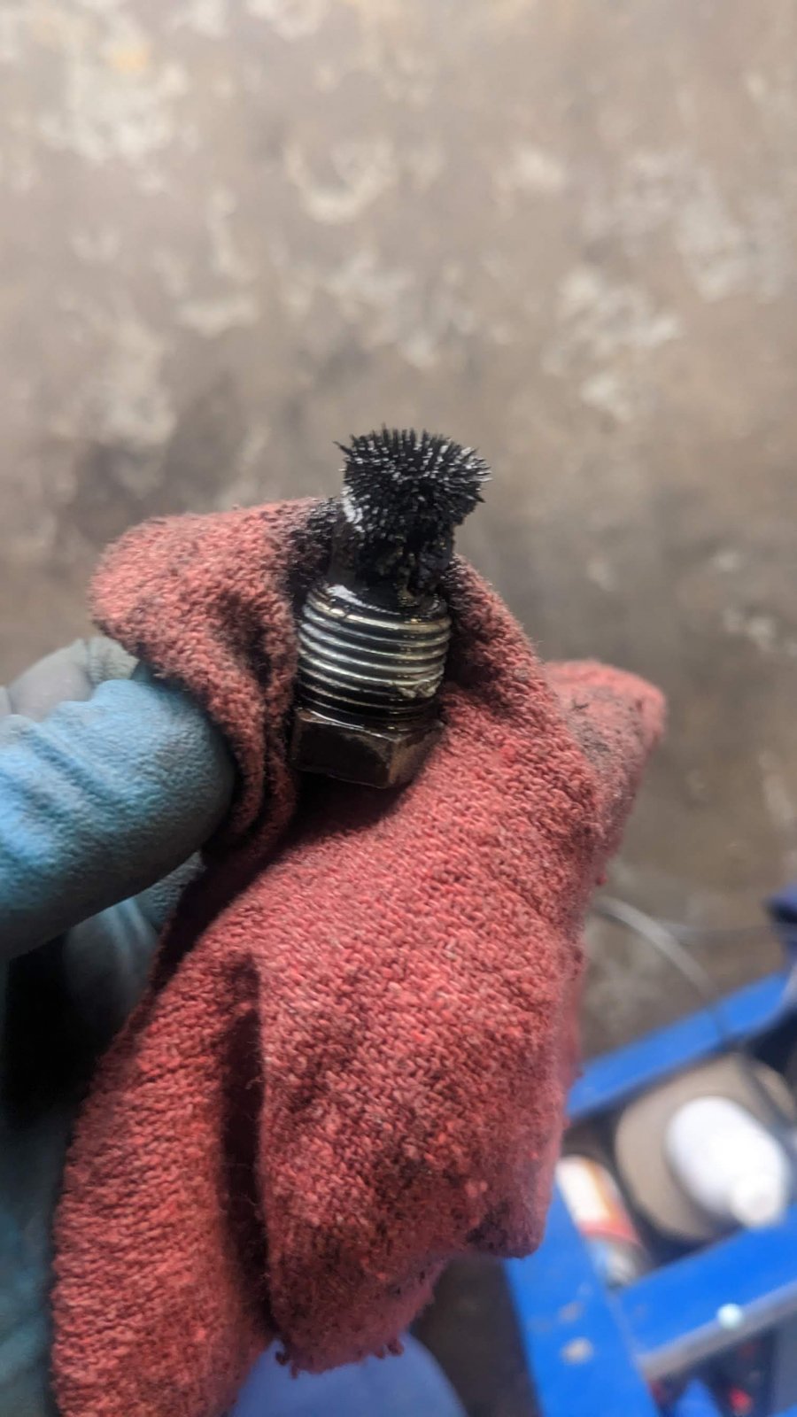

for reference, this was my transfer case drain plug when I got mine at 135k fluid was pretty black. it's now 166k and never shown any problem. I did change the fluid a 2nd time and there was no metal and fluid was clean.
if it's not worst than this and looks good the next time 5 - 10k later. I wooldnt worry about it until you see signs of failure
