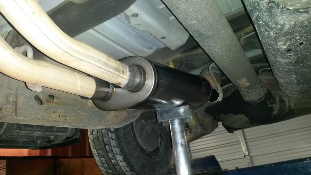

heres my exhaust

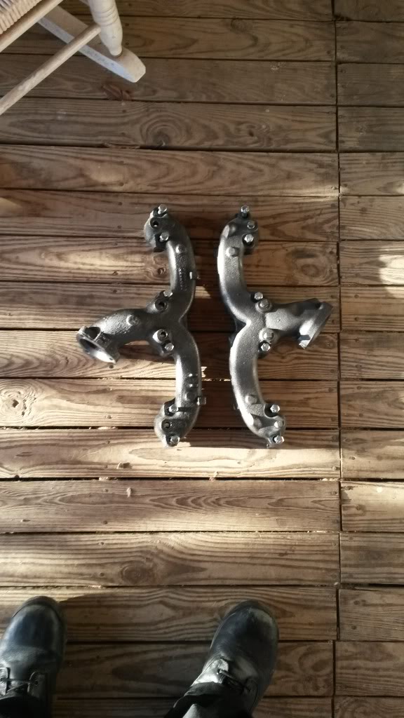

and yall both mentioned headers i have a brand new set of ramhorns i bought for my crawler but ended up not using think itd be worth the trouble to put these on?
