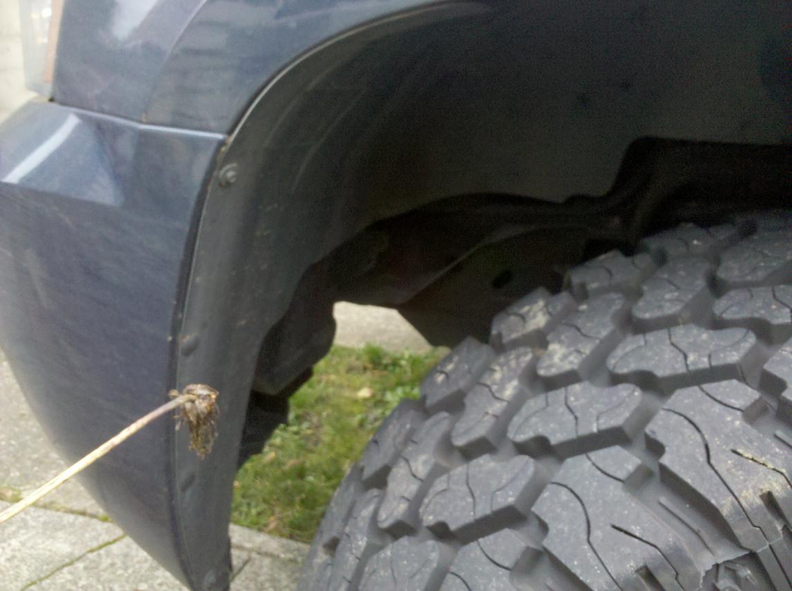

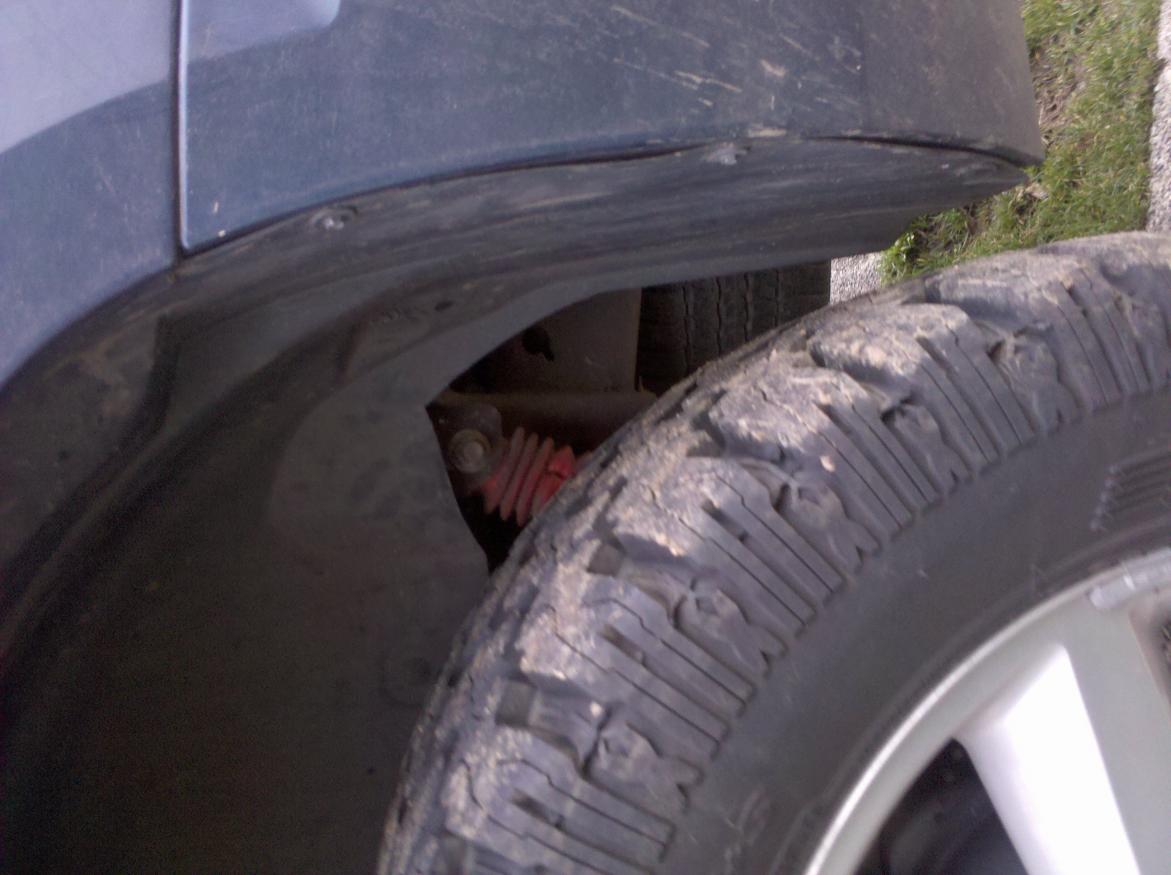

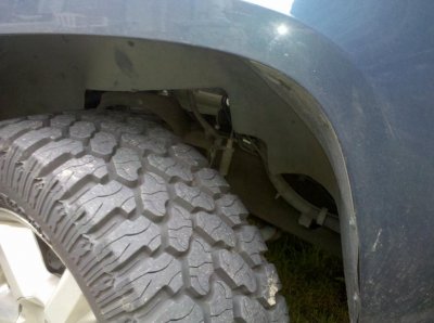

Attached are pictures of after the trimming I have done so far. These are stock 20in wheels with 305/55/20 Procomp Xtreme ATs. By the way, the tires are great! They handle the highway and city driving, great in the rain and through standing water, great in the snow, next step is the beach! Plus they are the only tires with a 40k miles treat wear warranty, which is nice.

I had the same problem at frist but I took a razor to the inner plastic and did some trimming. No more rubbing.
If you still have some rubbbing I suggest you turn the wheels to a full lock watch where they rub and then do some trimming repeat on other side. Good Luck!
