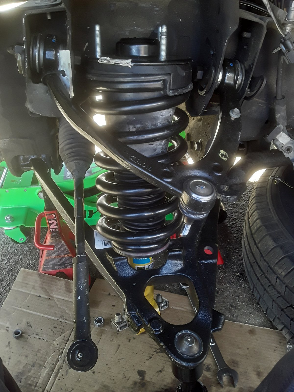

I've been buying parts here and there lately, decided to bite the bullet and buy Bilstein 4600s, Hellwig front/rear seay bars, moog front and rear end links, new oem front and rear uca, lca, oem panhard bar, moog 81069 rear springs, but a little stumped which fronts to get: the 81246, or 81248... any help/input will be appreciated. Took me a while, but had to get my gallbladder removed. Getting up there in the age bracket sucks.
You're going to be super happy with this. New springs make a massive difference as do the Hellwig sway bars. I also think the OEM control arms are of significantly higher quality than even the best aftermarket replacement. You won't need the Moog rear sway bar links since the Hellwig rear bar comes with adjustable ones.

I recently used Moog 81250 front springs on my 07 Yukon XL Denali, when I replaced the stripped down shocks and resistors installed by the previous owner, and put back the OEM Z55 suspension. According to Rock Auto, they were exact replacement for the OEM front springs, which are no longer manufactured.

Thanks for all the help guys. I've already bought all the items i need for a complete overhaul. I decided to go with the Moog 81250 front springs. They might be too soft, but the wife occasionally drives it. So far, i'm almost $2500 down the hole with all these OEM parts, but i know it's worth the extra $$$ for a decent, long-lasting ride.

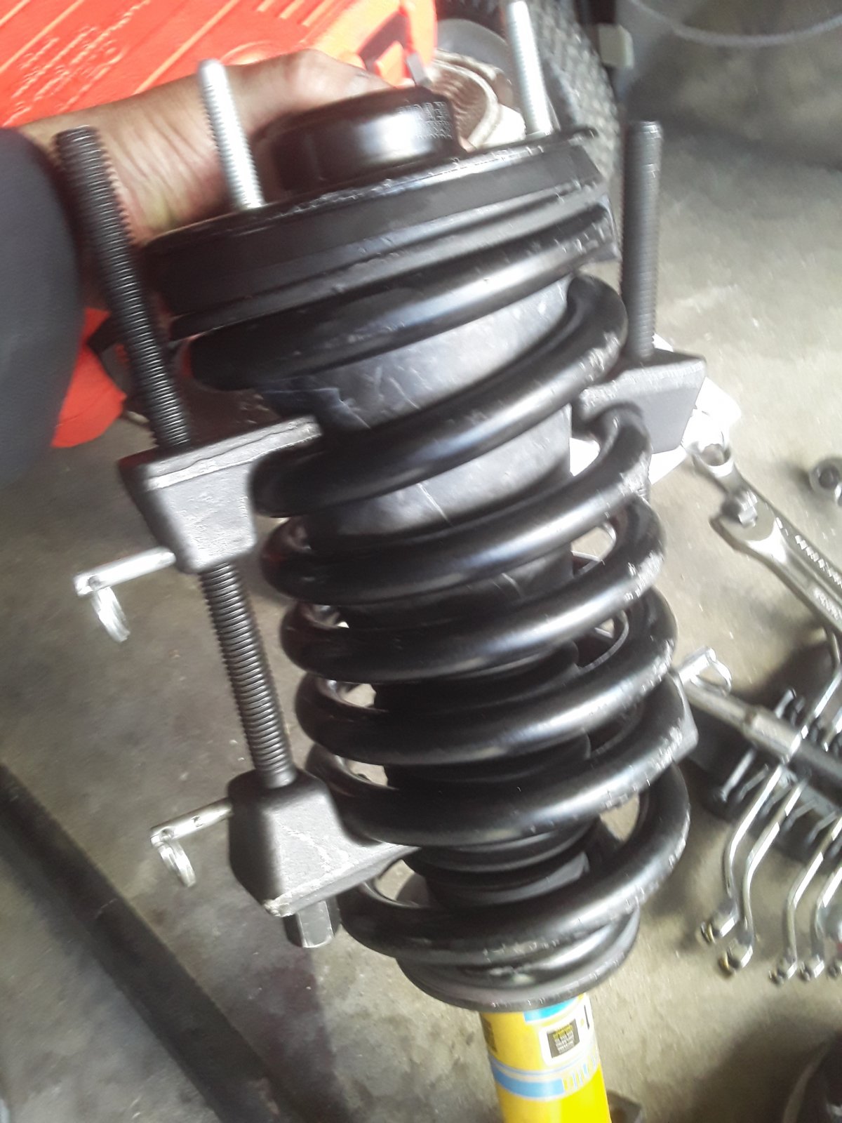

So.... i was installing my Hellwig sway bars today. The front sway bar was a breeze to install, but the rear one is giving me trouble. It looks like the U bracket mounting holes do not line up (they're farther apart than the body's mounting holes). I've read a few threads that installating was a breeze, yet i dont know if i have to order new mounting brackets that fit my 11 Suburban rwd. Has anyone encountered this problem?
Update: I just slightly bent the brackets just enough to line up the mounting points. It got too cold, so had to call it a day. I'll deal with end links tomorrow.
