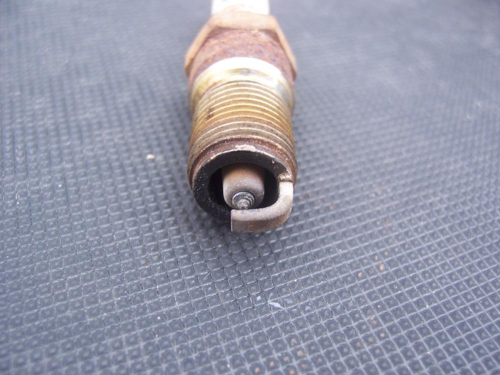

here are the plugs, sorry it took so long, i never get to do what i want to do on my weekends lol

What plugs are those name and number. They look to be the wrong ones. Signs of blistering and deposits maybe from engine liquids or fuel additives.

not sure of brand, they were in there when i bought it, all it says on the plugs is AC 41-932 25321614. i have put fuel additives in it, lucas oil fuel treatment, o'reilly auto fuel treatment and octane booster. and if it helps, it hasn't kicked up any codes when it happens so far
