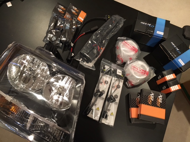

Parts before:

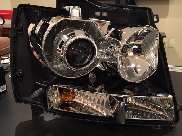

Used heat gun to open up headlamp. Projector in place:

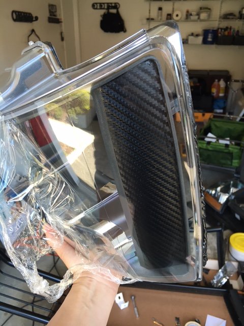

Blacked out reflector with carbon fiber vinyl:

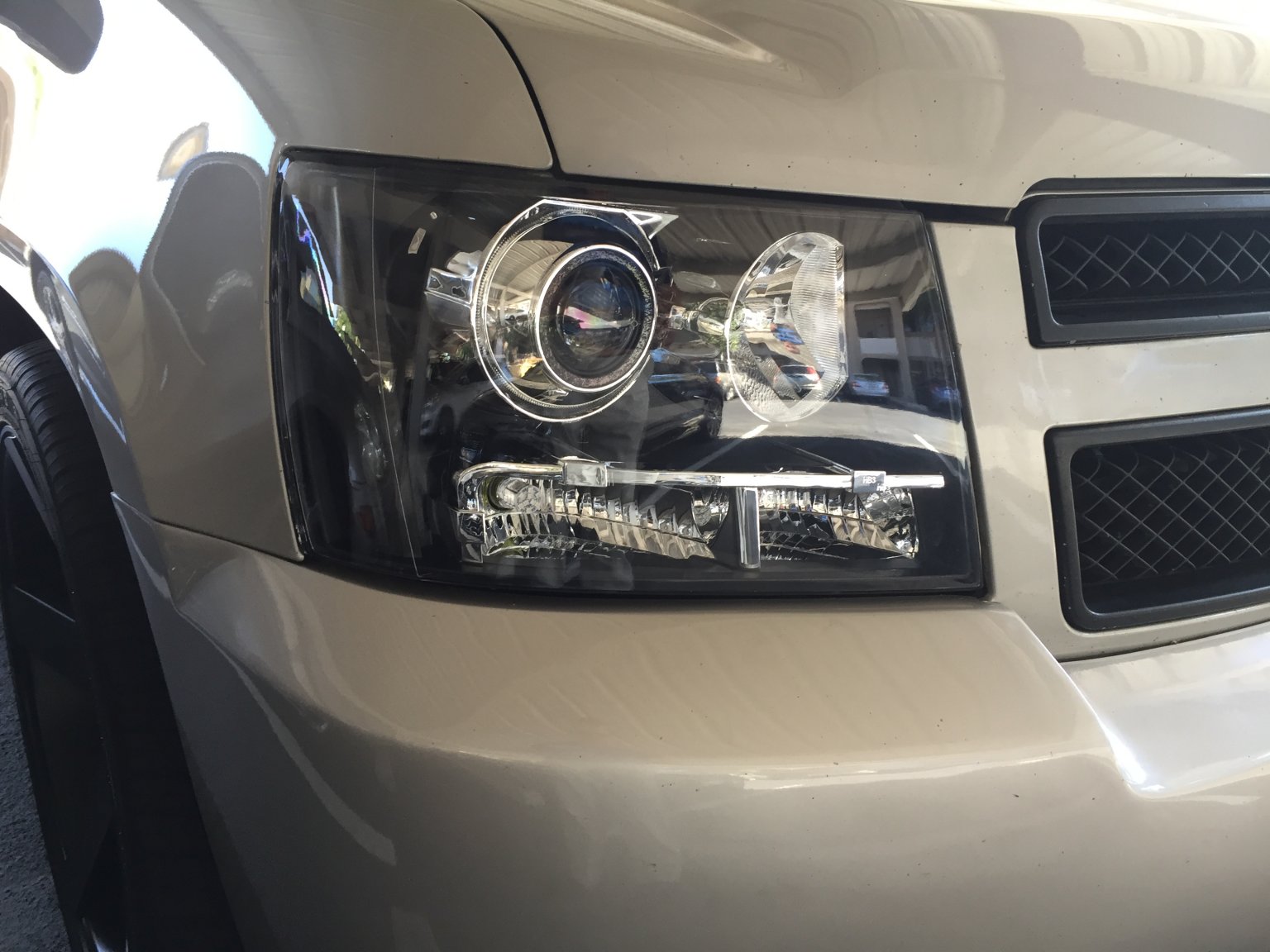

Finished product:
