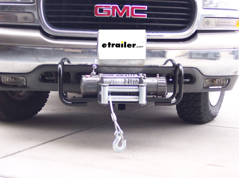

I was thinking about getting a winch too. Not sure how to tackle mounting since I have the ranch hand brush guard on there. I think it might be tricky getting it situated.

Pic of your brush guard. Anything is possible with will power.

You move the control box to te side, you have a long cord that plugs into te control box to send cable out and in. As for the free spool lever. You simply reach up in there and flip te switch.
I was planning to rotate the winch 90* so (the base play points to the engine. And the lever would be facing the bumper And easy to grab.
There is also wireless control in/out controllers also

What type of push bar is on this Tahoe? I have an 01 Yukon Z71 that I would like to mount a hidden winch and a Go Rhino type push bar on the front. I was worried that the lower bar of the push bar would interfere with the winch rope.
Any thoughts or suggestions?

I doubt it would interfere. If anything i might rub on tall things like if you try to recover a lifted truck
This is definitely the type I would mount if I had a 4WD model.
