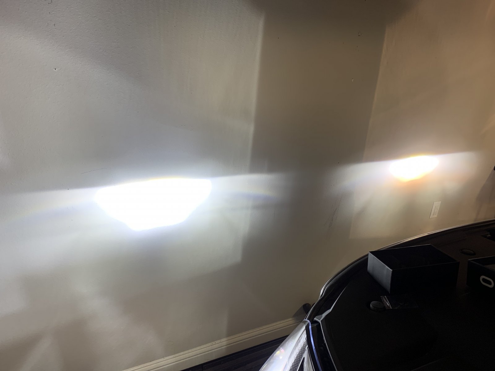

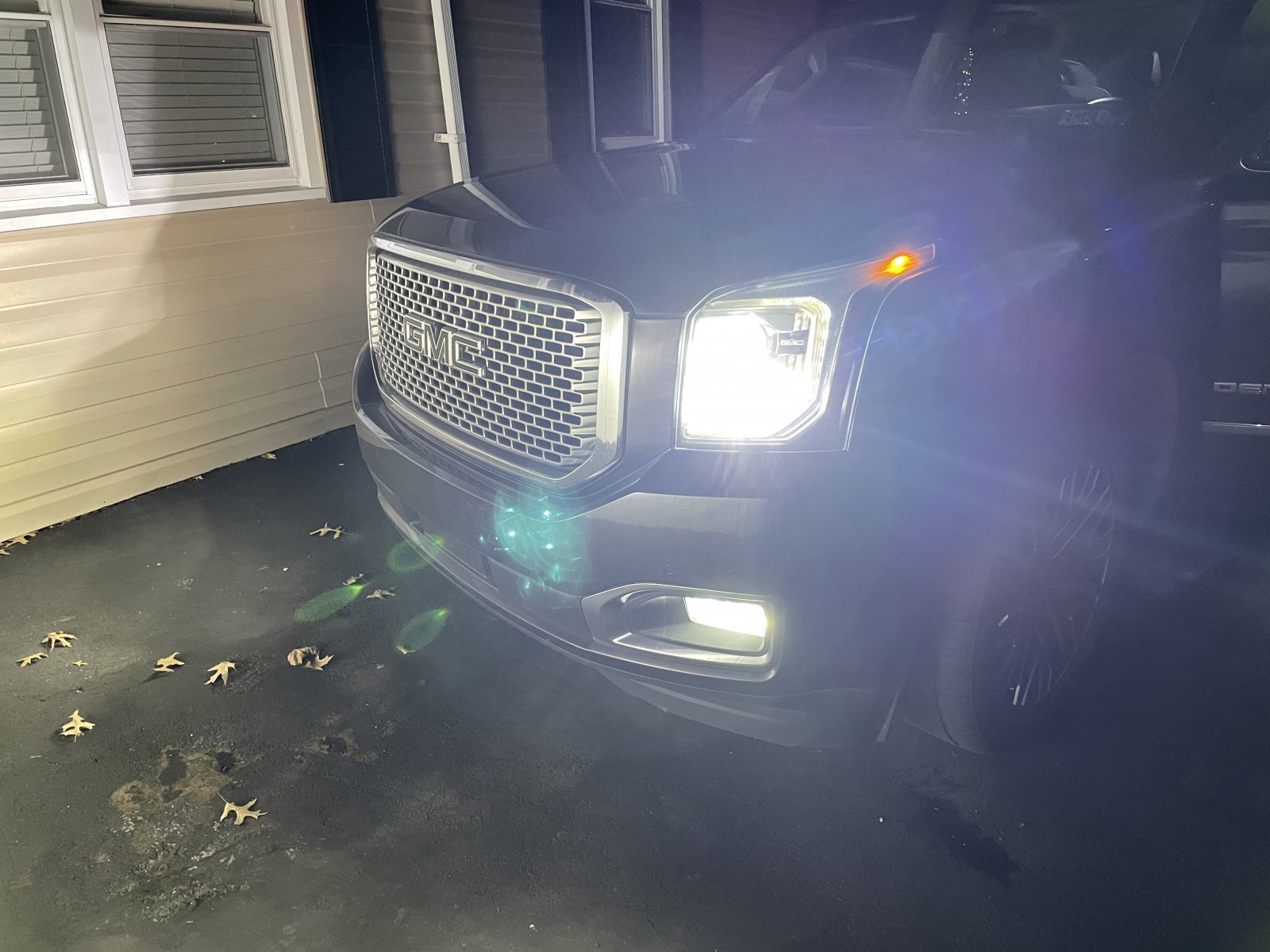

Installed the VLED micro extreme the other day they work great Side by side is of DDM tuning in both low beams, stock in the right high beam, and VLED micro extreme in the left high beam.D1C895B6-2AE2-44AF-904E-CB137E5A85E2.jpeg7ED19545-990C-4165-AA6E-465098C739BF.jpeg
