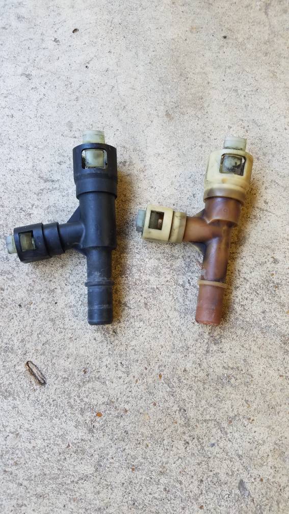

Got the hoses and fittings off.
The original OE fittings were still pretty solid and looked great except for the white one being discolored.
Flushed the core, both ways twice, switching back and forth hoping to loosen any crud and flushing it out.
After getting the new connectors on and buttoning everything up, let the engine get up to temp and topped off the coolant tank. Checked the temp coming out of the vents and it was around 160*.
We'll see in a few months if it helped
Pic of OE "T" connectors with 206k miles on them
Just my opinion... and I could be wrong... but I'm willing to bet those are NOT the original T-connectors at 206k miles.
