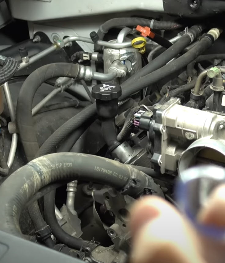

Heater core hose to water pump
mijohnst
mijohnst
Dec 16, 2019
250
275
So, I was going to do Scotty's suggestion, but after swapping my lines from what they were, my core stopped gurgling. The left core port goes to the left water pump outlet and the right to the right. I pulled this image off a YouTube and it shows the correct layout.
