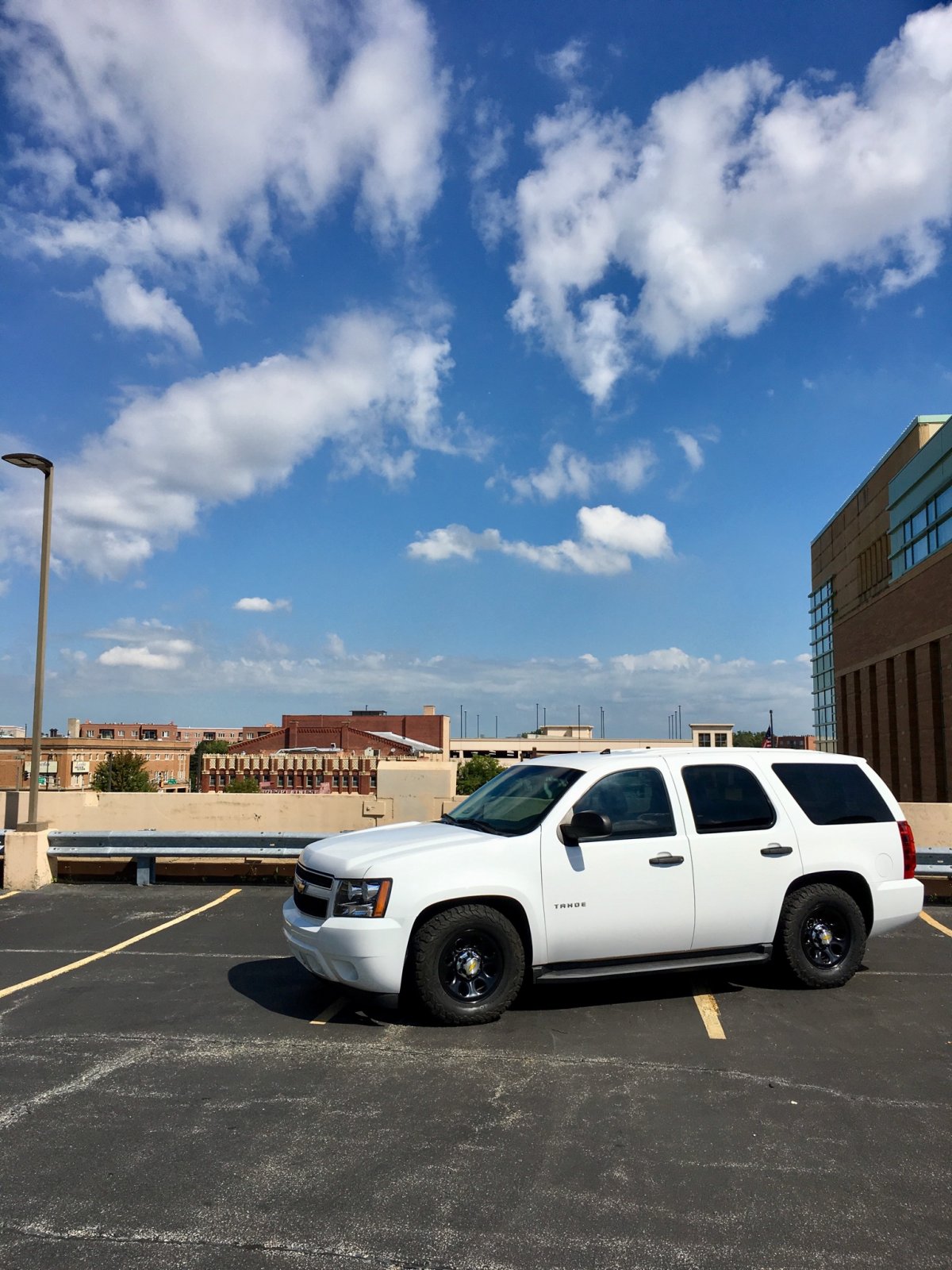

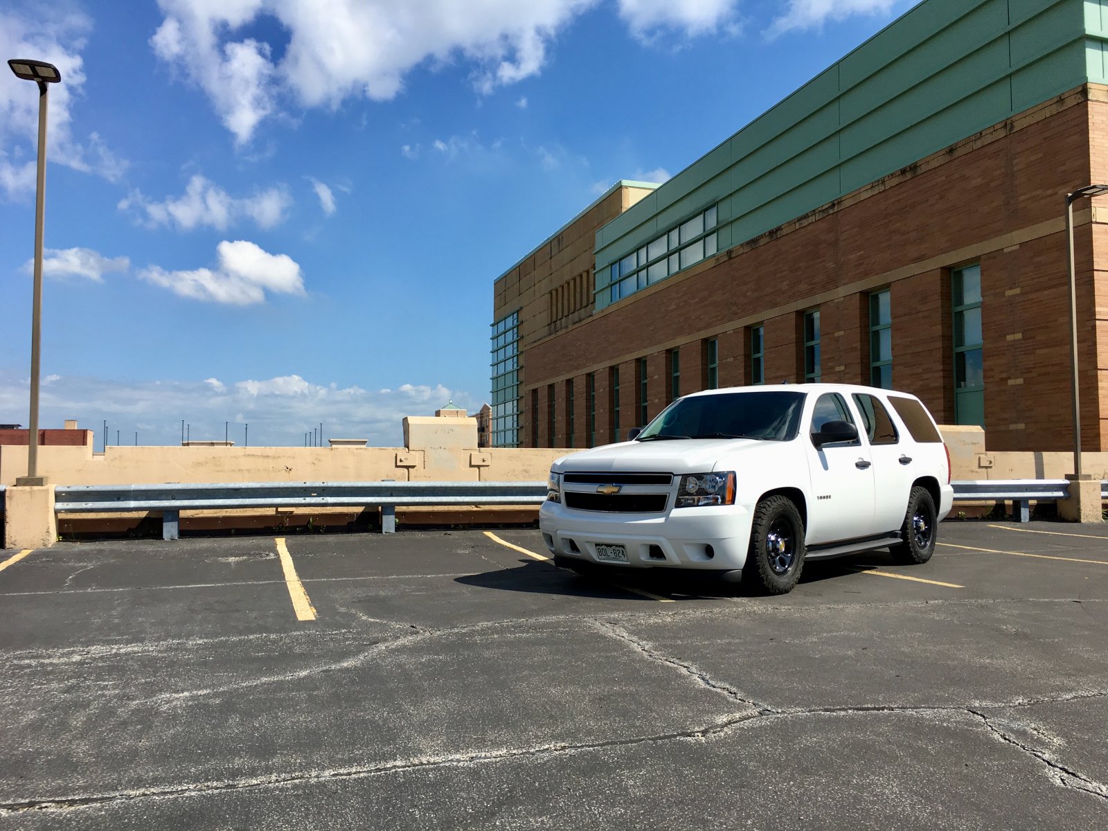

I have belltech 5305 rear springs and lowering knuckles in front.
Helper bags that go inside the coil springs.
Here’s my wife’s Tahoe in question. Used to be lifted.
