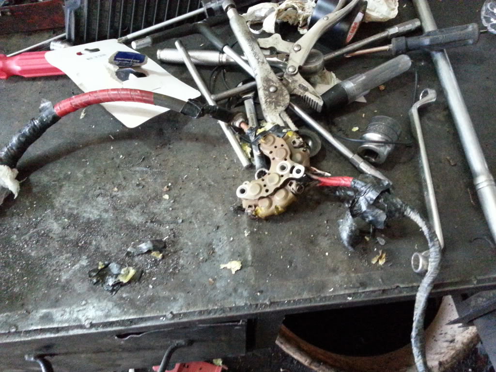

Today I started my project rewiring the e.fans but I was facing few obstacles, one of them was this:
This part it was used to connect the extra battery to the main and the efans too!
I was told that it from the Corolla alternator!
What I did is canceling this part and getting red of it and I connected the ex battery directly the main battery.
Is it right?

what in the **** are we looking at? looks like an electrical fire waiting to happen. i don't see a damn thing to do with efans here?

uh highly dangerous that thing is. you can parallel the batteries for more storage capacity but most people isolate them so on does not drain the other. like run a winch on the aux battery without draining the starting battery. and yes the efans main power line should be on the battery or a well engineered power distribution device of some sort.
It's a rectifier from an alternator with some wires attached to it.

What I want is to know is what it can be used for and why does the previous owner used it to connect the dual battery setup
I already know what it is the use is what iam wondering about

That my friend is called rigging it to work. And I must say that was probably done way before all the aftermarket items have become available so cheap now days. Toss it and get the proper items for a dual battery setup.
