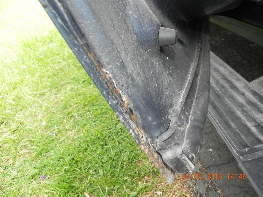

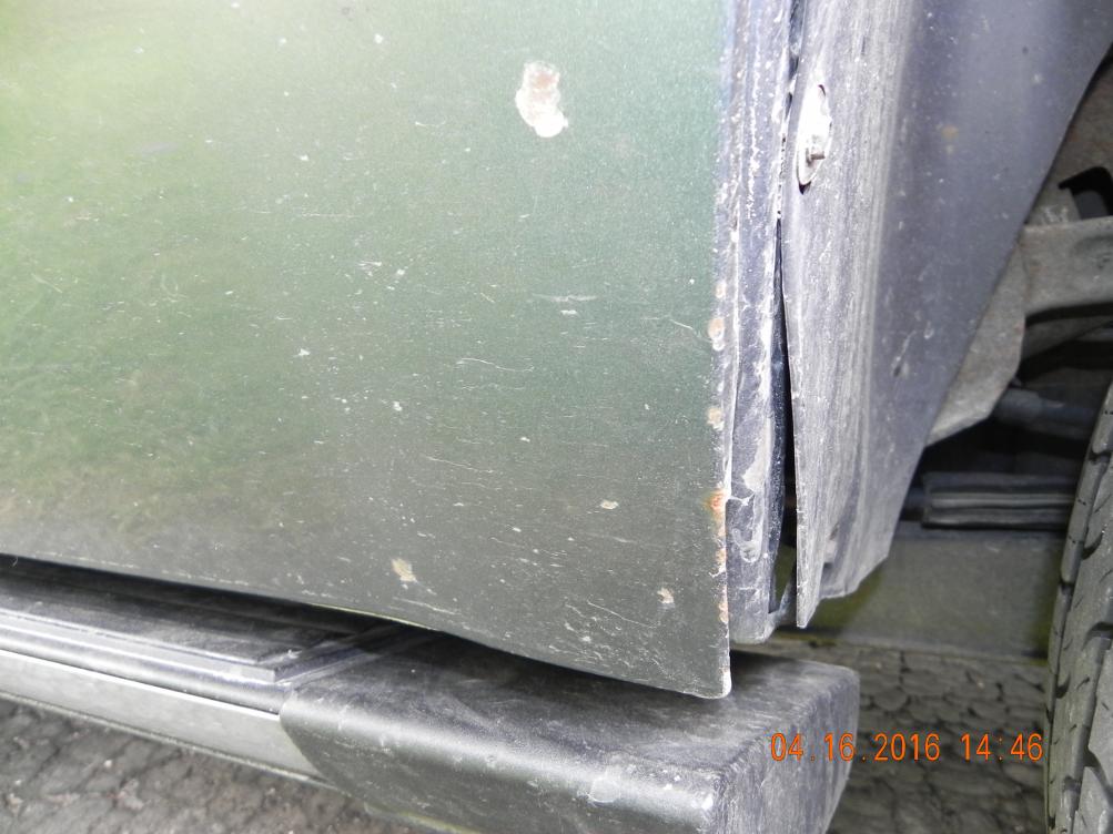

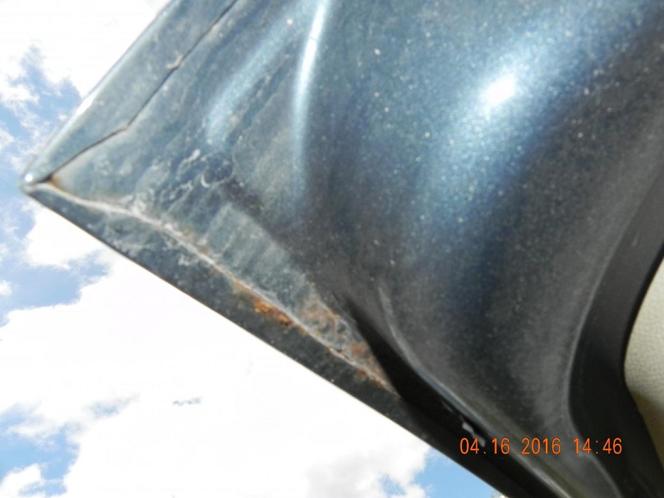

I have a 2008 Yukon Denali that I purchased about 6 months ago. I've noticed there is rust forming on the bottom of the hatch and the bottom-rear of the back doors. I can see why since the back edge of the door is basically the edge of the wheel well unlike if it was an XL. What have you done to remedy this and help prevent it from getting worse?

Rust needs to be stripped off entirely and repainted. Once the rust is removed and repainted that door skin lip can be sealed better with a can on duplicolor shaker can bedliner or plastidip. Any place where water can sit will tend to rust unless its sealed or cleaned in a regular fashion.

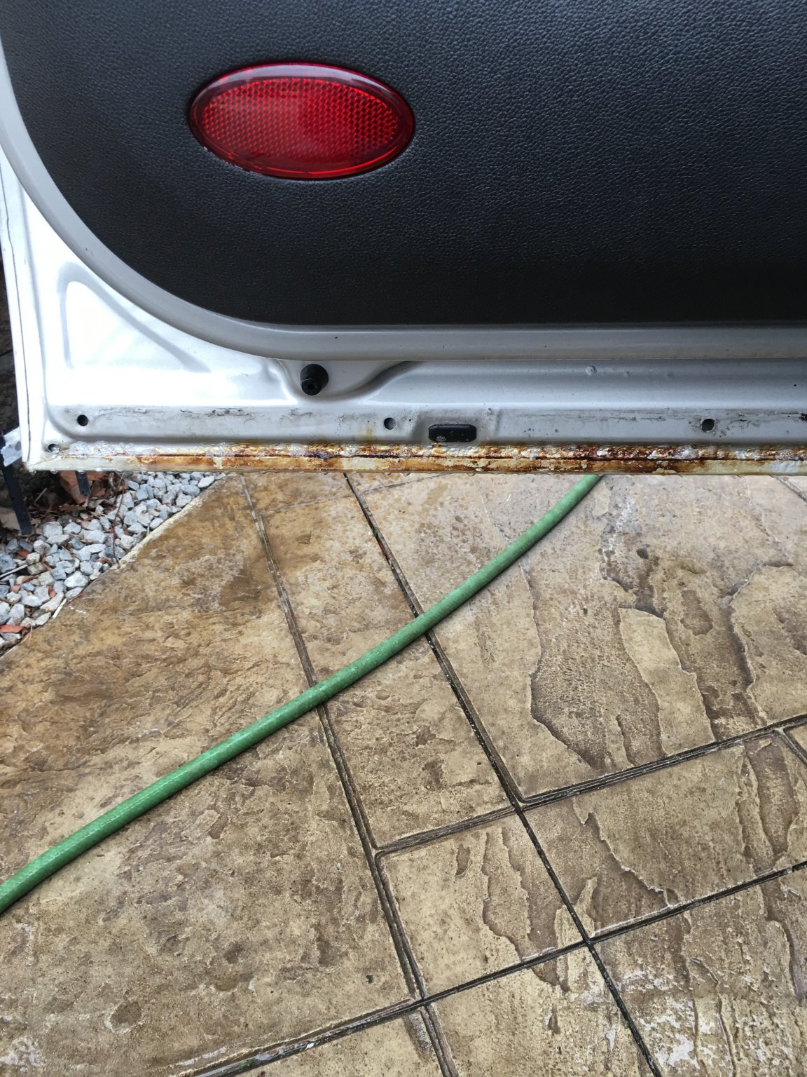

I was cleaning my truck today and noticed some rust on the lower corner of my driver door so i took the rubber part to find...
I think the best way is to sand blast it and repaint the inner part

Also check your drains in the doors. They are notorious for clogging and allowing water to sit in the door pockets, thus causing that rust.

Old thread I know, but for the archive... spray Fluid Film on the inside of each hole where the rubber strip connects using the straw that comes with the product and also spray it on all the visible rust on the outside of the lower door. Clean out the drain hole. Do this once a year and it will most likely keep it from progressing. I'm on year 3 and it looks no worse than the day I discovered it on all doors and lift gate in the same spots as depicted above. Fluid Film is amazing. Search it on Amazon.
