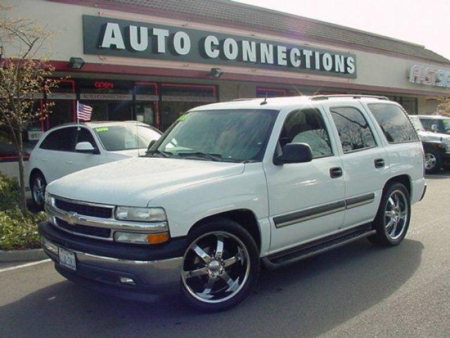

I recently picked up an '05 2WD Tahoe for my wife to drive and to take over summer towing duties (21 ft camping trailer, ~5000lb loaded, WDH). We looked at a few before settling on this one, which my wife really liked.
One thing she wasn't too keen on are the wheels, which will be changing out. The original plan was to swap with the wheels I have on my silverado (flat, 5-spoke 17" wheels that came stock on 2005 Tahoes). While swapping the wheels, I quickly figured out something I hadn't noticed before... it was lowered. I attributed the improved look to the aftermarket wheels and as this is our first Tahoe I hadn't noticed the drop. It became quite obvious though when I tried to put the 17" wheels on the front. They wouldn't fit because it has drop spindles and the wheel interfered with the lower ball joint bolts. Plan is now to find Silverado LTZs... Current wheels are Boss 330s with 305/40R22 tires.
Anyways, the questions:
1) Any ideas on how much it's been lowered? I'm guessing about a 2/4 based on pics in the sticky drop guide. What's the best way to confirm? I noticed the drop spindles and that the rear springs are a progressive rate spring, but nothing else stood out as obviously modified.
2) Should I be concerned about decreased towing ability with it being lowered?

looks like a 2/3, 2/4. Maybe put some helper springs out back to help with the towing some. But other then that everything should be fine.

I did a quick measure on the wheelwells last night. My driveway is not real flat, so it was 33 1/2" on LF and RR, and 34 1/2 RF and LR. So, average 34" all around.
Think it's up high enough for the stock Firestone kit? Do they make one for lowered Tahoes or do you have to piecemeal it?

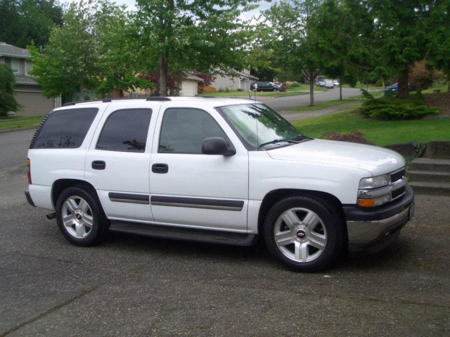

Update: traded for some 2008 Silverado LTZ wheels. Looks much better.

Those new ones dont look bad, but damn, those 330'sfor looked 100x better IMO lol.....
Mike
Alex33
May 6, 2009
1,235
25
Looks nice with the new wheels. Really digging the OEM+ look they give.
