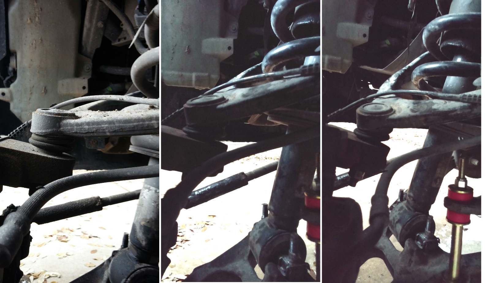

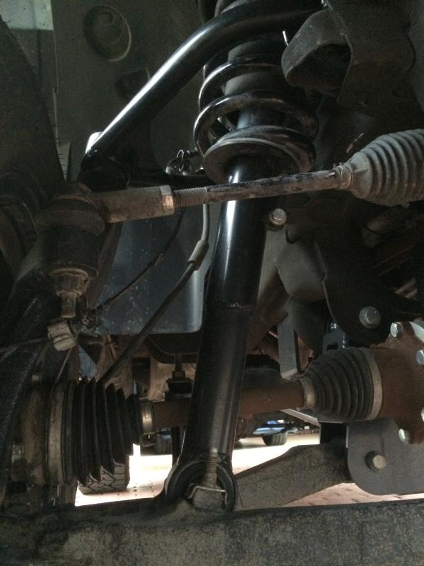

I took pictures of the upper control arm joints but the cv joints were about the same...
and here is a after and before* picture... truck is a bit dirty because it has been raining quite a bit.

I installed my 2.5" front spacers today and you are correct, the joints are definetely being pushed to their limit... Do you think the rough country 3-3.5" lift control arms will work with 4 inches of spacers? Those are the highest lift arms I was able to find...
You indicate lift control arms. Do you mean spindle? Control arms do not provide any lift.
In any case those ball joints look like they are at a pretty good angle. I will need to check mine, but IMO at on 2.5" they should not be at that angle.
Well I drive every day 40 minutes to uni and I jump a curb everyday and park offroad... I'm planning to get muddy tires for that same reason, it gets pretty muddy around here.
Is your rig 2WD?
