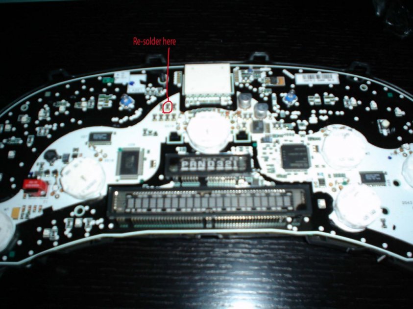

Any advice on replacing the stepper motors that run the gauges? I been trying to find a write up or something on here on doing it, but haven't had any luck.... Also I noticed in the pic of the red LED conversion the trans position indicator is dimmer than the DIC. Mine is the same way. Is there a way to fix that, or is that how they're made?
Of course I did a write up on that. It should be a sticky IMO. Here's the link.
http://www.tahoeyukonforum.com/forum/showthread.php?t=42521
I also have this problem and would like to fix it.. Is this something that can be done?
I have already replaced the bulbs in the cluster so I am experienced at taking it apart.
