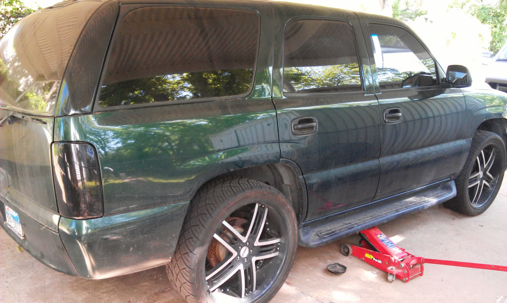

Jack up the body on the side you removed all of the bolts. I used a 2x4 along the side steps to lift the body.
