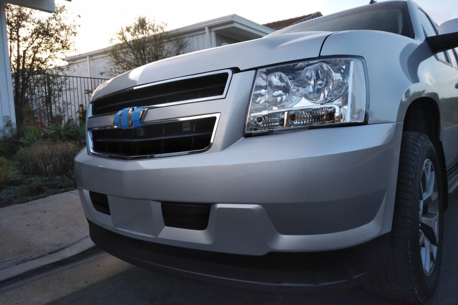

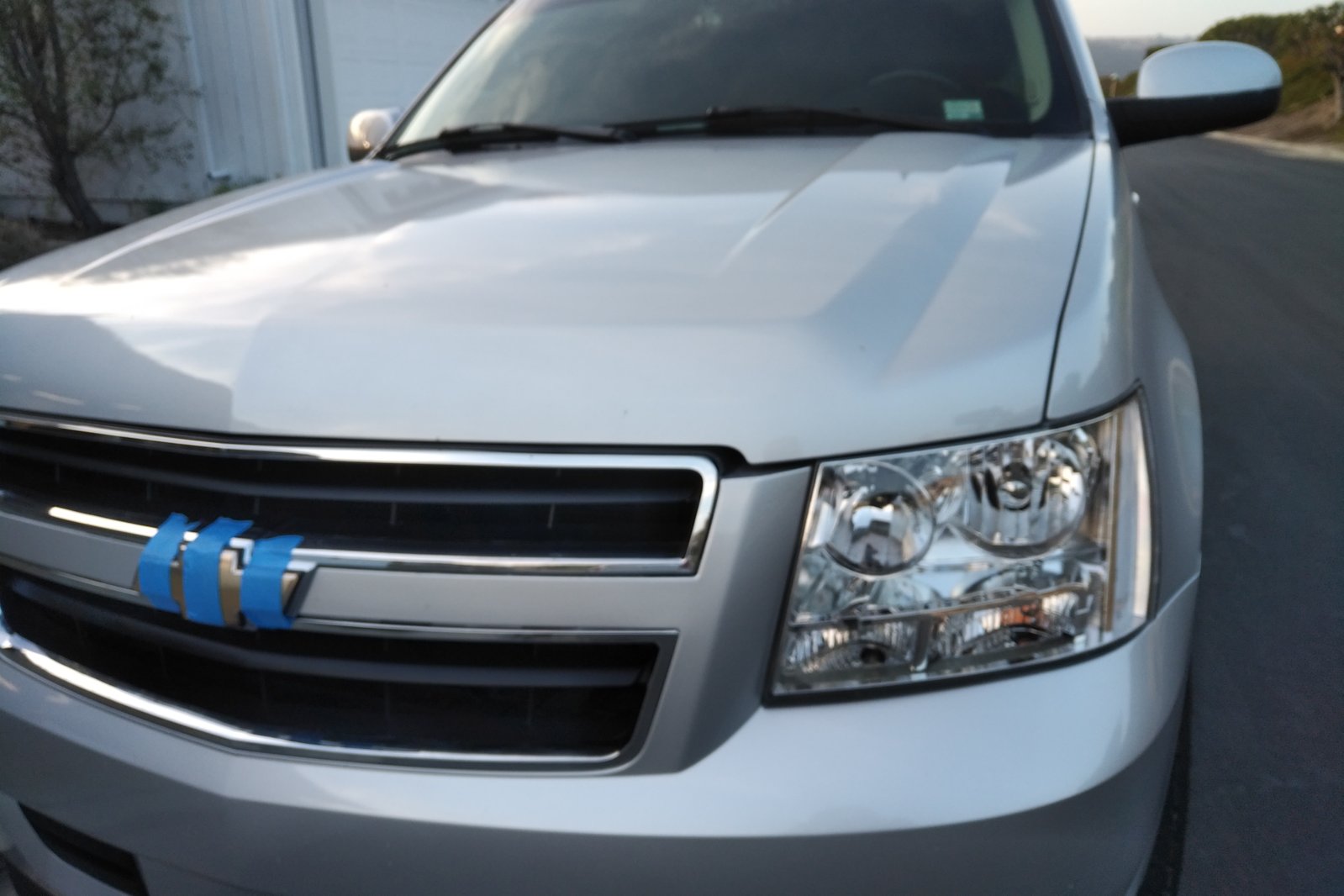

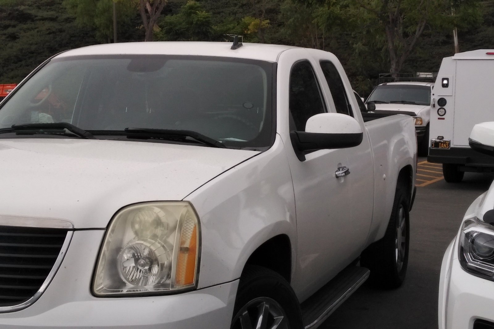

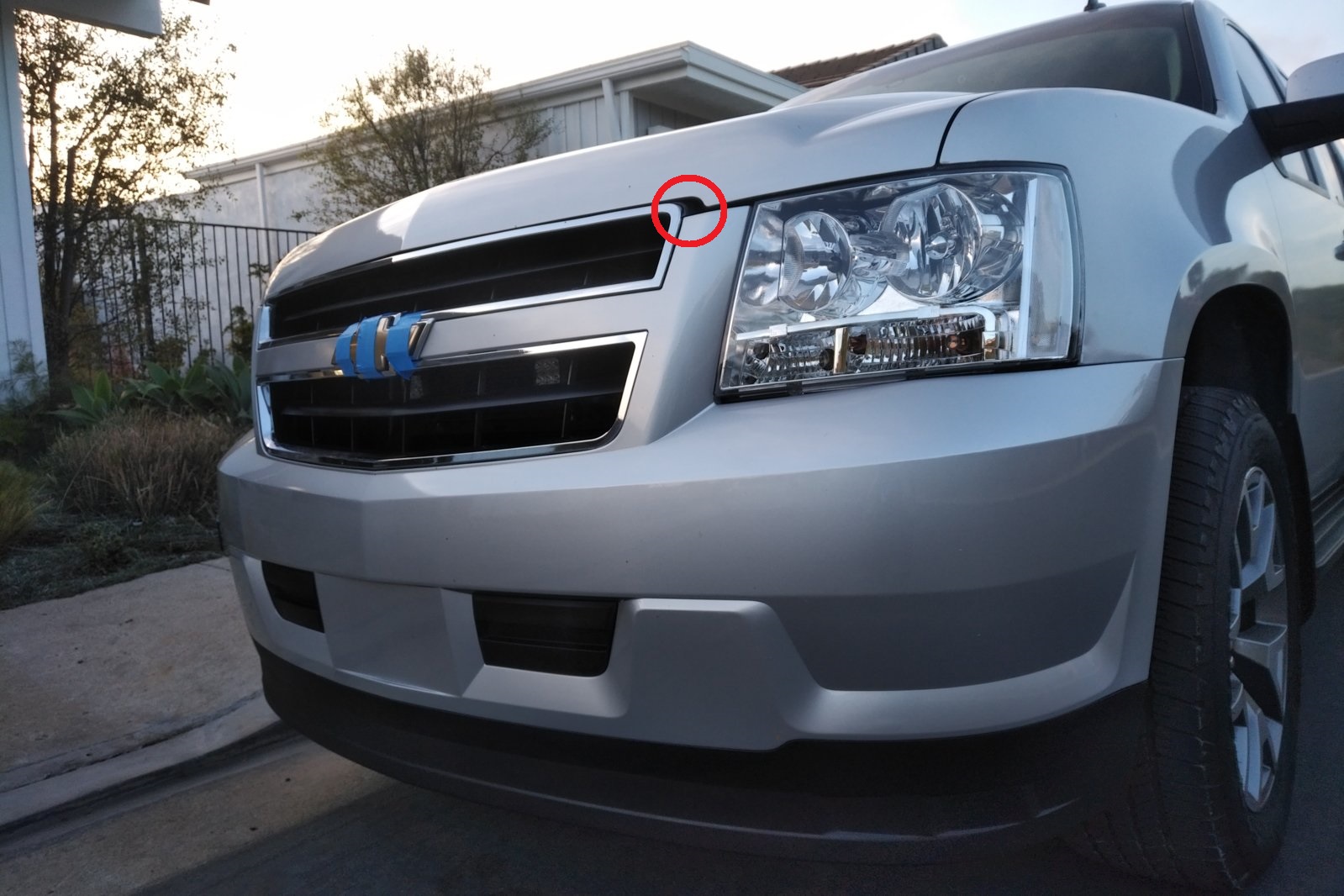

Hey you guys sorry to stir up an old post but I really like the squared look of the Tahoe Hybrid and did a lot of research since I have a Suburban... So I finally came across a used OEM bumper on eBay local pick up in San Diego ( 40 minutes from me ). Picked it up and had it color matched to my paint... Bought a used OEM top grill piece from a Tahoe Hybrid on eBay and the bottom grill piece on eBay BUT from a China seller and China product... but whatever! The "tow hook covers" and bottom air dam are on order from Chevy San Diego with 3 left in stock... otherwise the fender lines match up perfectly... the under bumper mounts fit perfectly and along with the headlights... the only thing and if you see in the picture with my horrible water damaged headlight the hood is about an inch back from the bumper since the Tahoe Hybrid hood is aluminum and stamped differently than the reg. Tahoe's and Subs... otherwise IT IS POSSIBLE and makes the truck look 2018 and not the ugly old style fog light bumper that they put on 100+mil trucks... Here are the photos of it... and since I was doing paint work I had the side emblems and moldings removed... plus added Escalade 3rd Brake Light + OEM Escalade Tail Lights and did brake light over ride turn signal modification. Waiting also on my American Flag design front bow tie... Again.. sorry to stir up an old post but I finally got my truck finished.. Hope all is well to everyone, and happy holidays.. I am new here thanks again.. and YES my license plate is just US...

IMG_20190130_1640370.jpg IMG_20190130_1640346.jpg Here's a final update of my suburban with the tahoe hybrid front bumper along with the air damn pieces and tow hook covers installed... my bow tie has glue drying don't worry doesn't always look like that. As you can see in the second pic that's where you can really see the hood not lining up.
Thanks guys let me know what you all think!
Cheers

So just to clarify, the hood is also from the Hybrid model? And it's aluminium?
