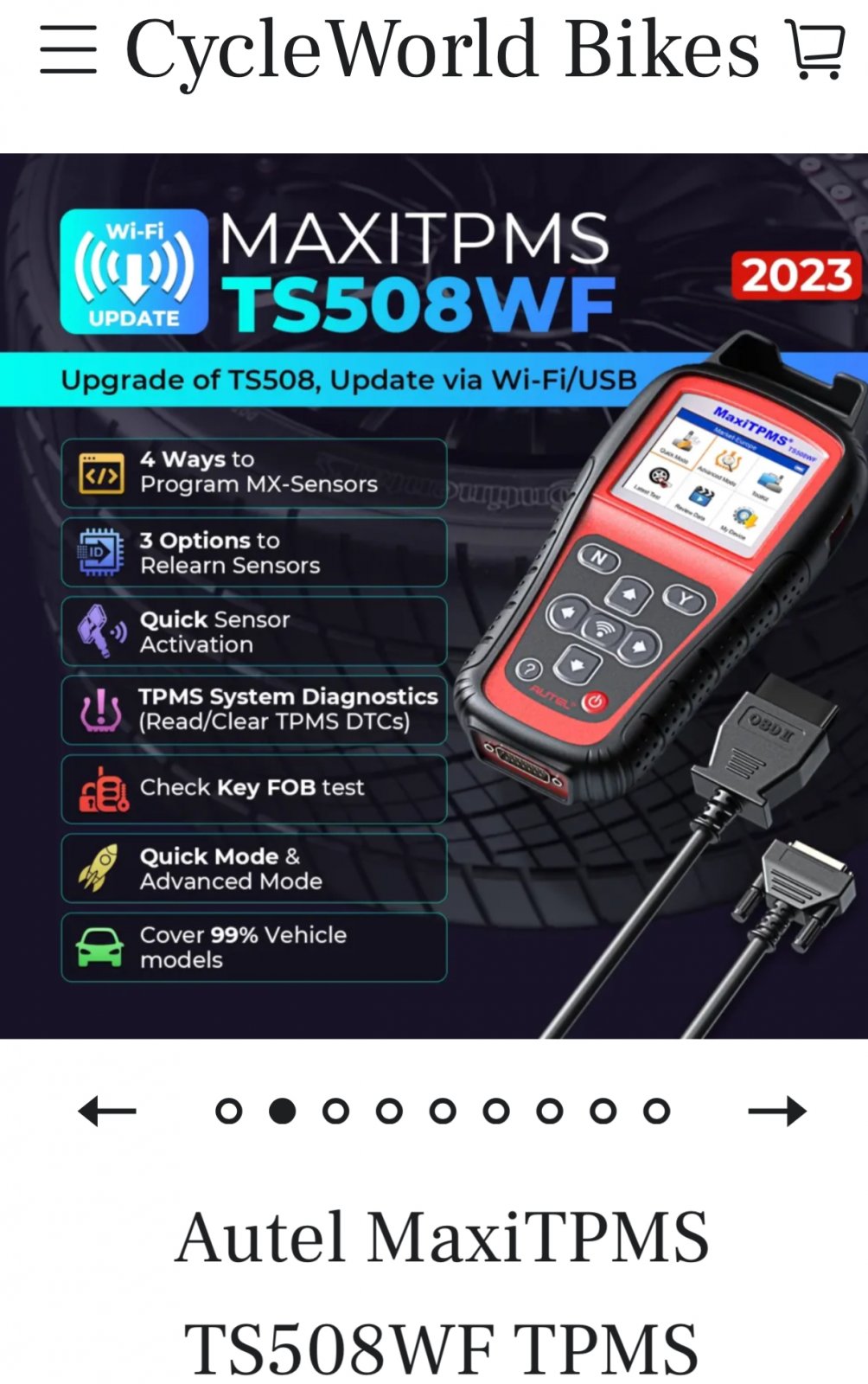

Hello dear friends here in the forum.
Today I can share with you my solution to my Schrader 21507 sensor problem.
I bought the MAXITPMS programming device TS508 from Autel. Apparently my sensors
1. weren't awaked and
2. The ID wasn't stored in the ECU.
With this device, it was super easy to read out all the sensor IDs and then store them in the ECU via the OBD2 interface with the included cable. The device was currently on offer for €150 and I snapped it up. The advantage here is that I have a lifetime license and updates. I cover the US, Europe, Asia and Australian markets. I can access all of this in the device. Furthermore, I think it's nice that I can clone all the sensors, which helps me in the winter when I install my winter tires. So I no longer have to learn everything again, but I have the same IDs as for the summer tires. The device can do much more. Therefore, the purchase was more than worth it for me and my fleet.
If anyone needs help with this, I would be happy to provide information and of course I would be happy to help you. I still wanted to thank everyone here who tried to share their knowledge with me. Everything works again and I'm reassured that I didn't buy the wrong sensors.
Many greetings to everyone and happy Easter from Germany
Markus
