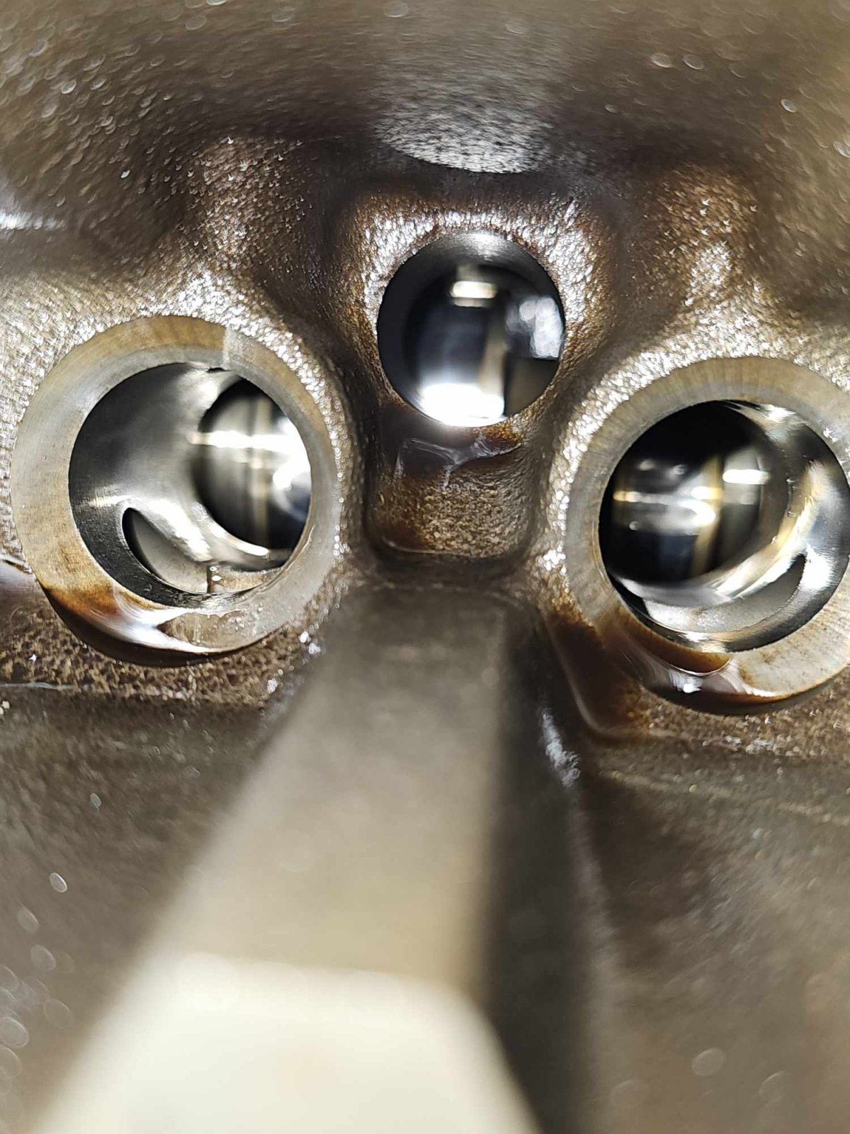

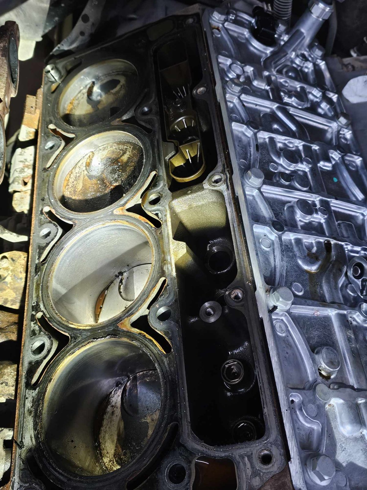

Not sure why half the muffler has mud on it and the other half is clean. Hmmm
