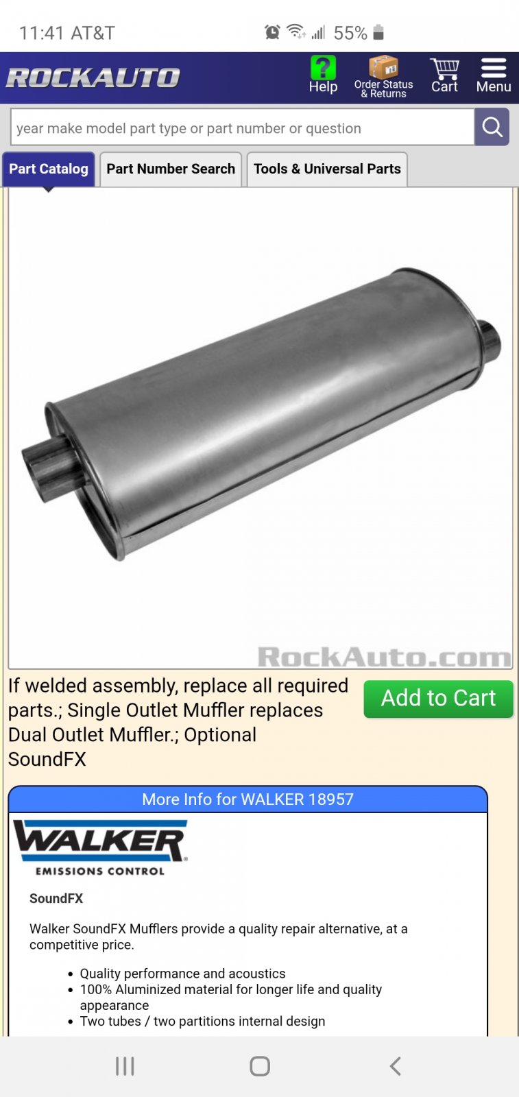

please give us the specific year and specific model too please. i did find one muffler from walker thats supposed to be oem. it specifically has a notation that it replaces the stock dual outlet muffler. but specific year and model may point to an odd 1 yr design change or something.

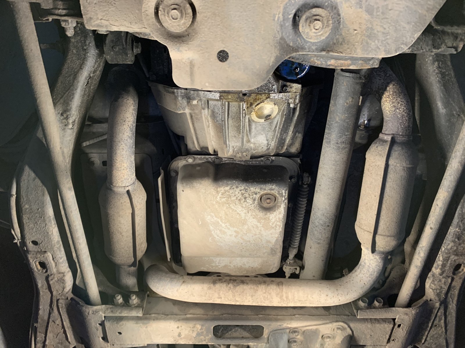

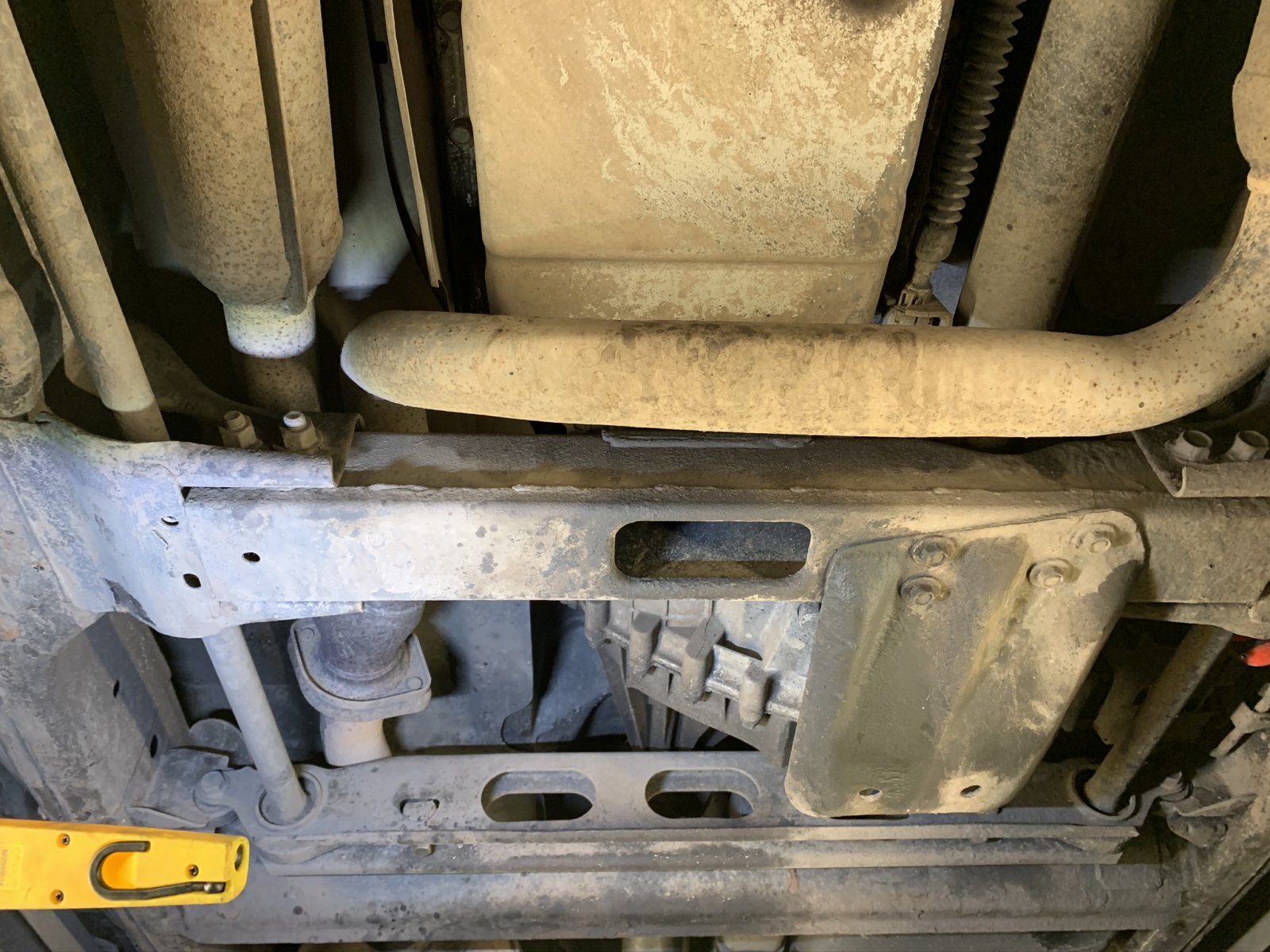

So here the cats come from the front, yes I have a leaking oil-filter. Will be replaced soon.
Cats here connecting to the single 70mm/2.75 inch tubing that goes to the muffler:

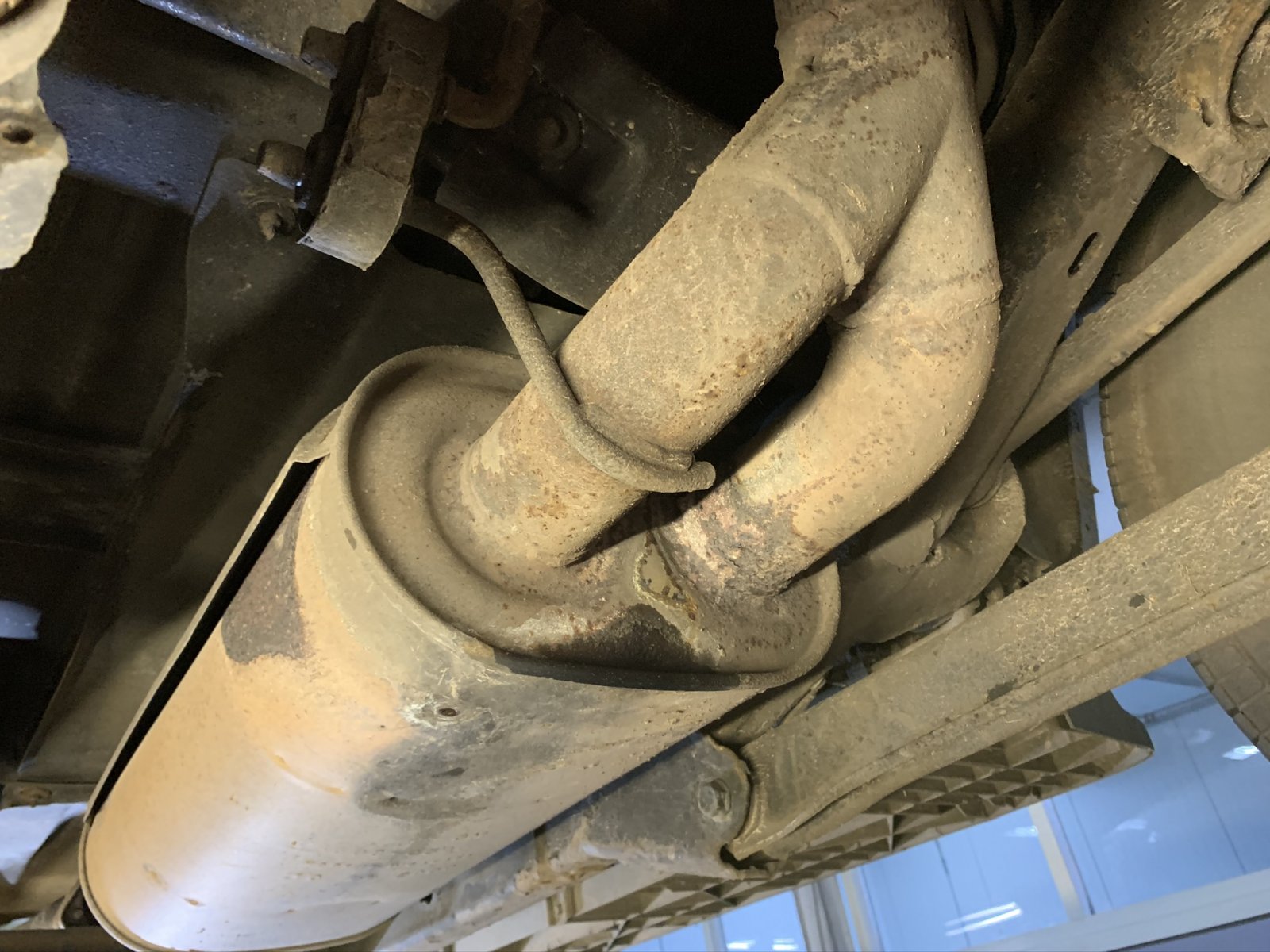

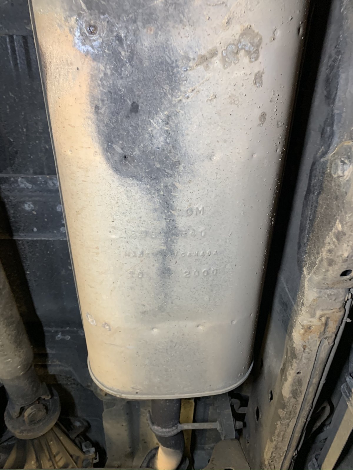

So 2.75 inch into muffler:

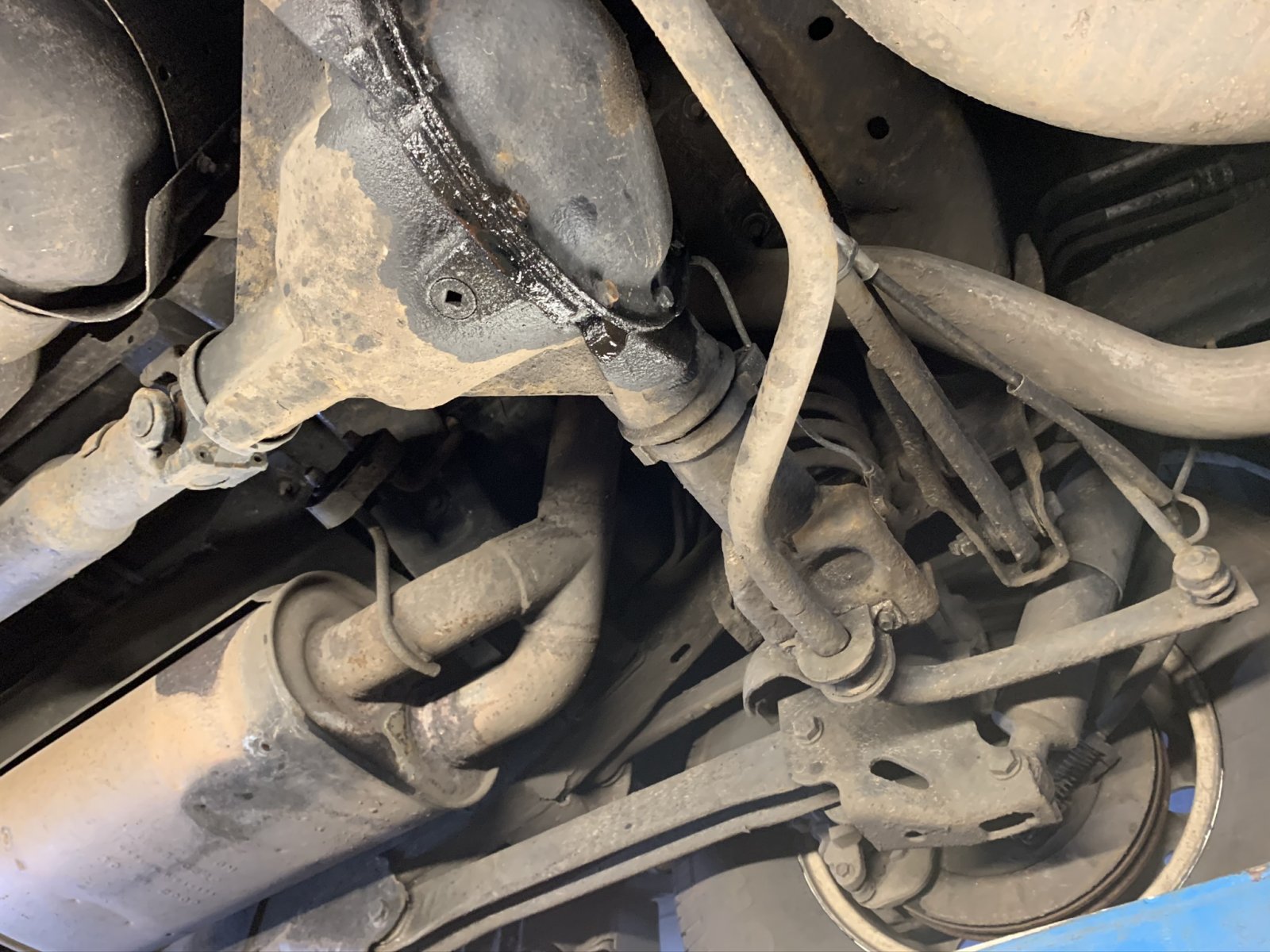

Then dual 3 inch out of muffler, and you can see them forging into single 3 inch:

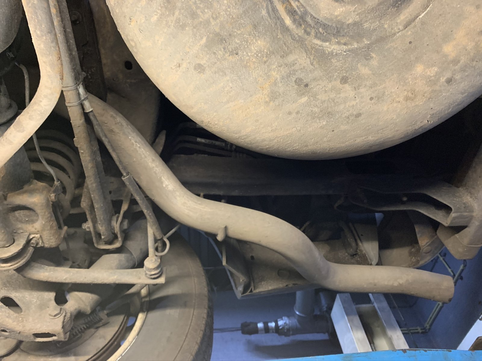

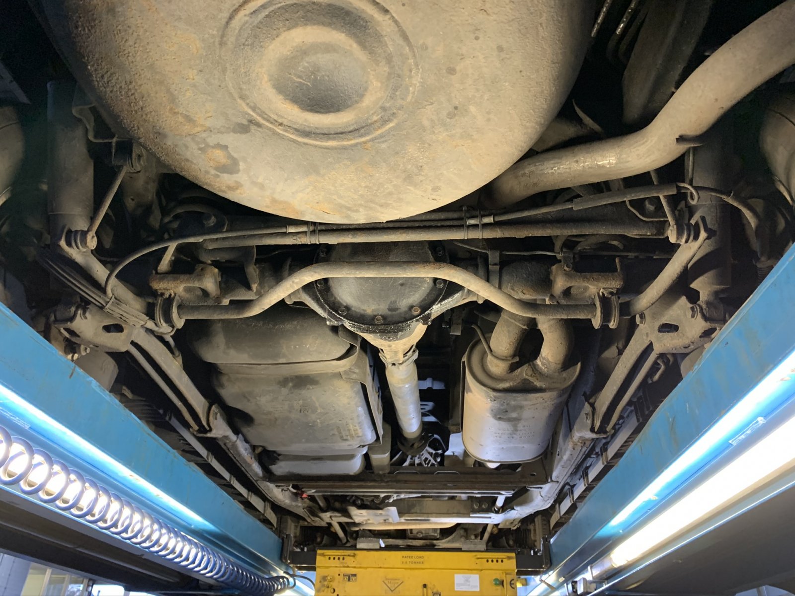

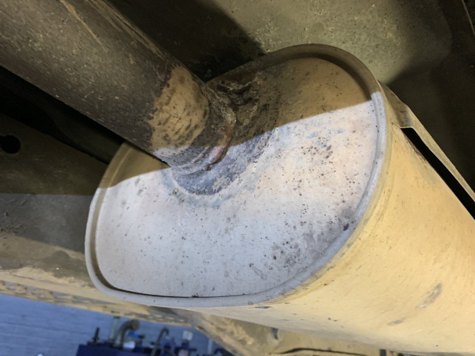

Wich then comes out of the back of the Hoe: and yes my diff will get a new gasket too :)
And we Dutch people call this a large muffler. A truck has smaller ones here in the Netherlands ;)
