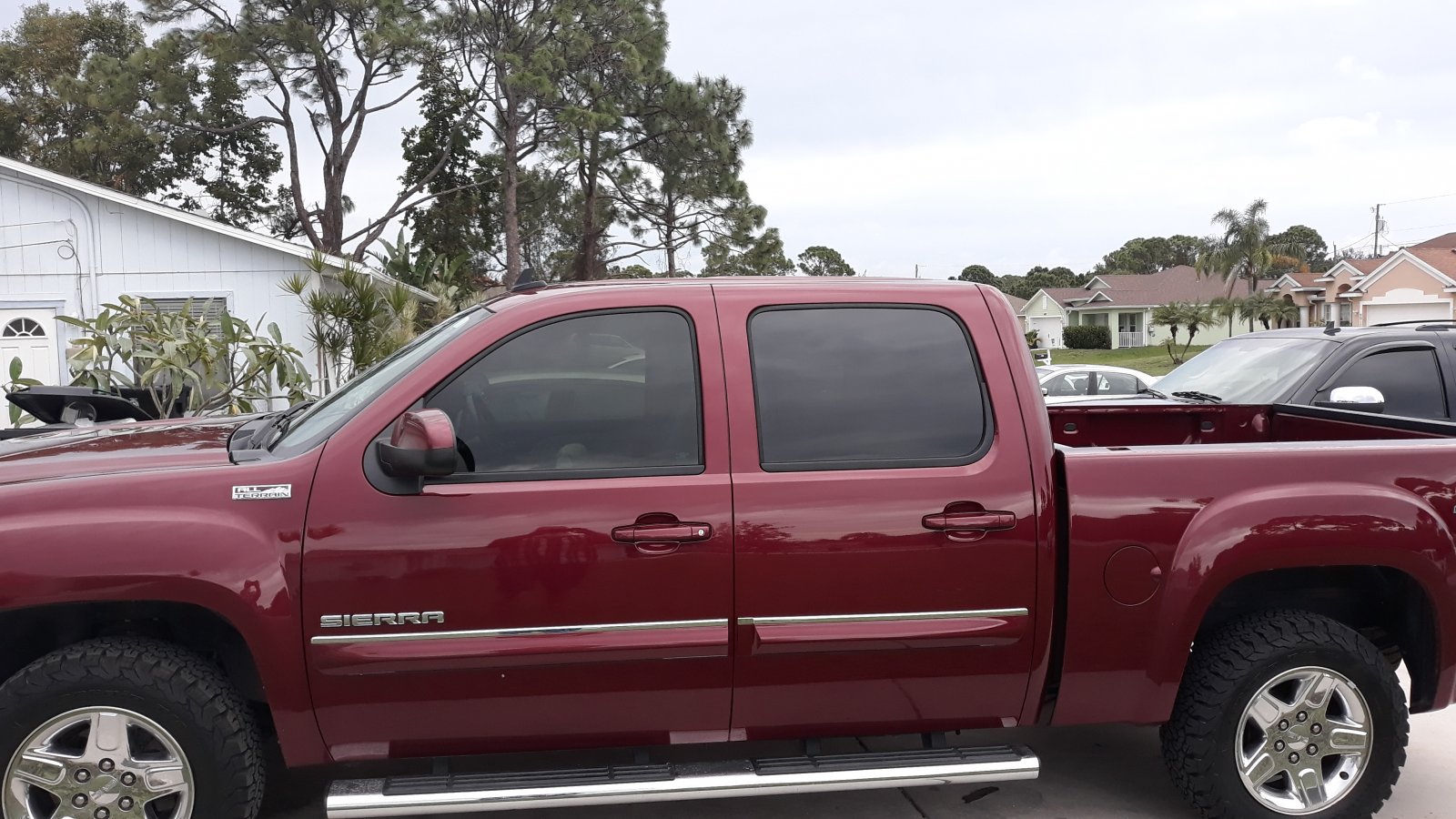

I did some more googling with better search terms and came across a math formula that explains how it is calculated.
Original x Aftermarket / 100 = Combined Percentage
So, we're not lawful up front but one can easily see inside and the rears are well within limits. The tint man did write back with an explanation that stated I would never have any issues with the law with the front tint. We shall see about that!
Julia was pulled over a couple of weeks ago in the white Sierra by a State Trooper whose premise for stopping her at night was that her tint was too dark. Yeah, that'll (probable cause) fly in court. He had trouble climbing up onto the running boards with the 35s and 6.5" lift. He was wrong about the rear tint and right about the front. He gave her a warning.
Like many of you, she's not going to do a thing and stated she would just pay the ticket should she get one.
Many thanks to all those who tried to 'splain it to me and failed! It's not you, it's me; been a little slower than normal lately.
Thus endeth the lesson!
