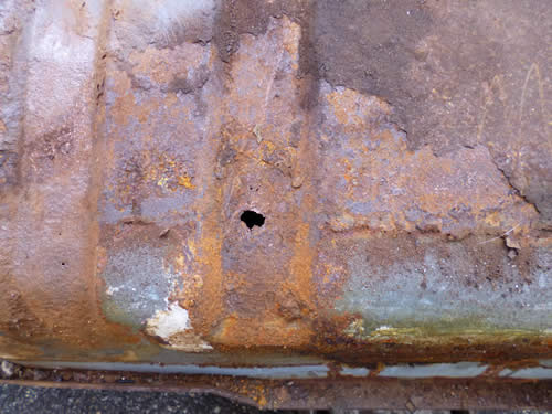

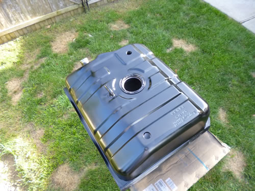

Yeah I did mine last week. And of course it's more than just doing the fuel pump with my truck... the tank had rot and a hole in it, so I had to order a new tank! I painted it and clean the crap out of everything. Nice and new.
