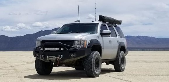

I would call my 2011 Tahoe Lt an overland build and I love it. It has a lot more room inside than a Toyota and not that much bigger outside. It is not a serious rock crawler but, neither is the Toyota.
Most of the overlanders I do trips with are not out rock crawling because their intentions are to get out in the wilderness without breaking their rig...
Sleeps two comfortably inside on a 5 inch foam mattress and still has room for gear. (something a Toyota has trouble doing...
