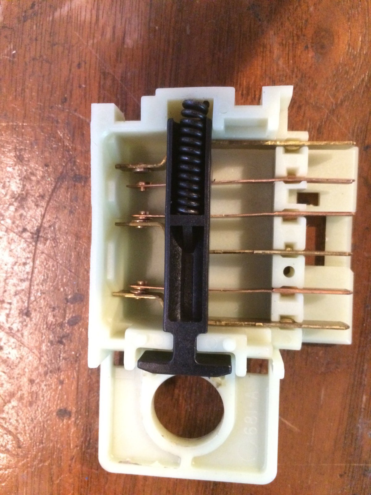

I had a code for a bad brake light switch. I replaced it this morning, and took the old one apart to see what was bad. I figured I would post pics of whats going on inside, since this is a common issue....
The truck is an 04 Yukon XL 1500, with power adjustable pedals...
First off, here is where its located:
And here is what it looks like with the cover off:
Notice there are 3 normally closed connections and one normally open.
Here you can see what it looks like when you press the pedal:
On my switch, the normally open side was not closing all the way. You can see in this picture the burned terminals from making intermittent contact:
Here is a pic of the all the terminals. The ones at the top of the pic are the ones that were having an issue:
Hopefully this will answer someones questions about why the brake light switch can be a problem.
I put a new switch in. That only took about 15 mins. Now I have to go get the ABS light turned off and hopefully my issue is solved!

Mike nice pics, those switches are pretty cheap, but if you were cheap like me You could have fixed the switch with a nail file ,or emory cloth. but its easier to change the switch.

Nice to know it's so simple inside and easy to repair if someone was in a bind and had a few minutes to clean the contacts. Mine's a GMT900, so it's probably got some ******** like Hall effect, infrared or microwave proximity sensors for each circuit instead of simple contacts like that.
