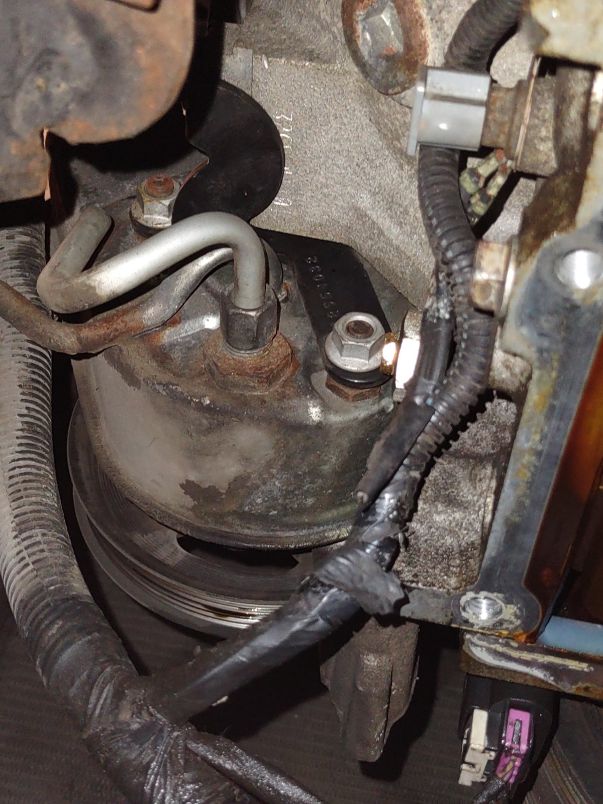

Speaking of leak - have you noticed any oil pressure drop with oil leaking? I have a couple of leaks from the oil cooler lines that need to get swapped.
I think it is. However, we put a lot of hours on the truck this week (21+) and the oil pressure was normal. Going to get it up on a lift and pinpoint the oil leak tomorrow.
