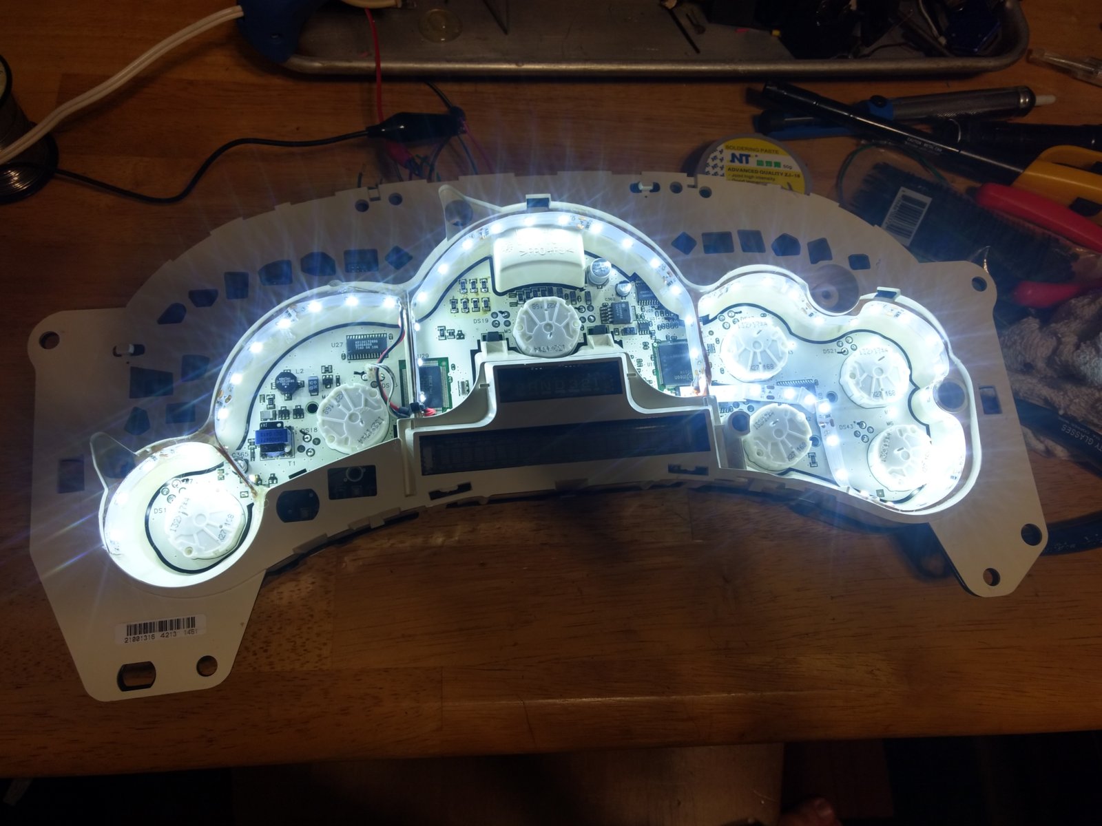

Sounds like maybe your stepper motors are going bad on your gauges. They are a pretty common problem on 00-06 GMs. Pretty simple and cheap to replace though.
05alive
Mar 2, 2015
413
314
Masshole
You have to replace the whole cluster panel display, right?
nope.
Very basically, you desolder the motors and resolder in new ones.
There's a guy here who does lights on speedos all the time, I think he does stepper motors too.
Need to send him mine this summer, I'm out a few lights, and three steppers are dead.

Yep, changing the stepper motors is fairly easy "IF" you know how to solder and UN-solder. That's the hard part, soldering skills. If you are NOT skilled at all in soldering on electronics, then you can possibly damage the circuit board. But once you get a little practice, it's really easy. The main thing is that you need to learn how to get the solder hot enough to melt it, but NOT get the circuit board so hot that you damage it.
I am actually working on a cluster right now for a member on here.
I have @Bigbeardenali1992 cluster at the moment about to get new stepper motors and the blue LED treatment. He also sent me some sweet blue needles to install on it as well. It's gonna be sweet when it's done. I'm just stuck at the moment waiting on one more new stepper motor.
