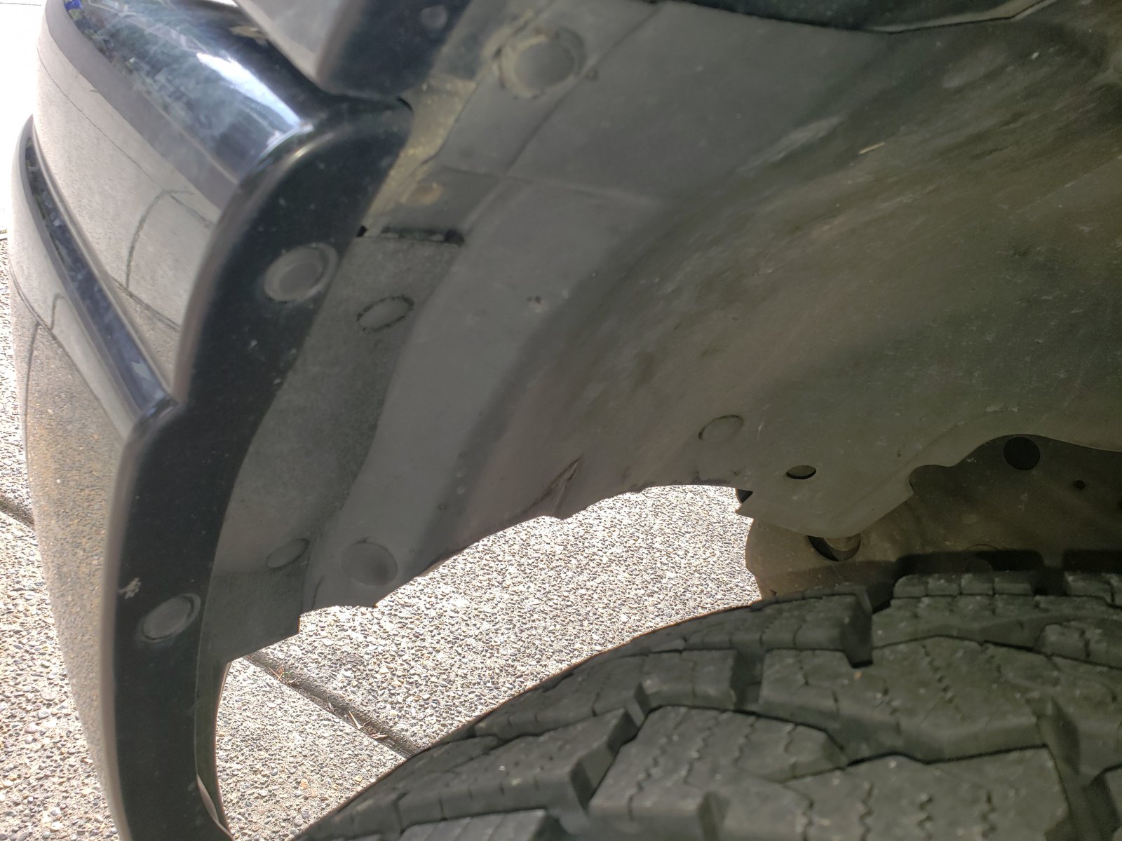

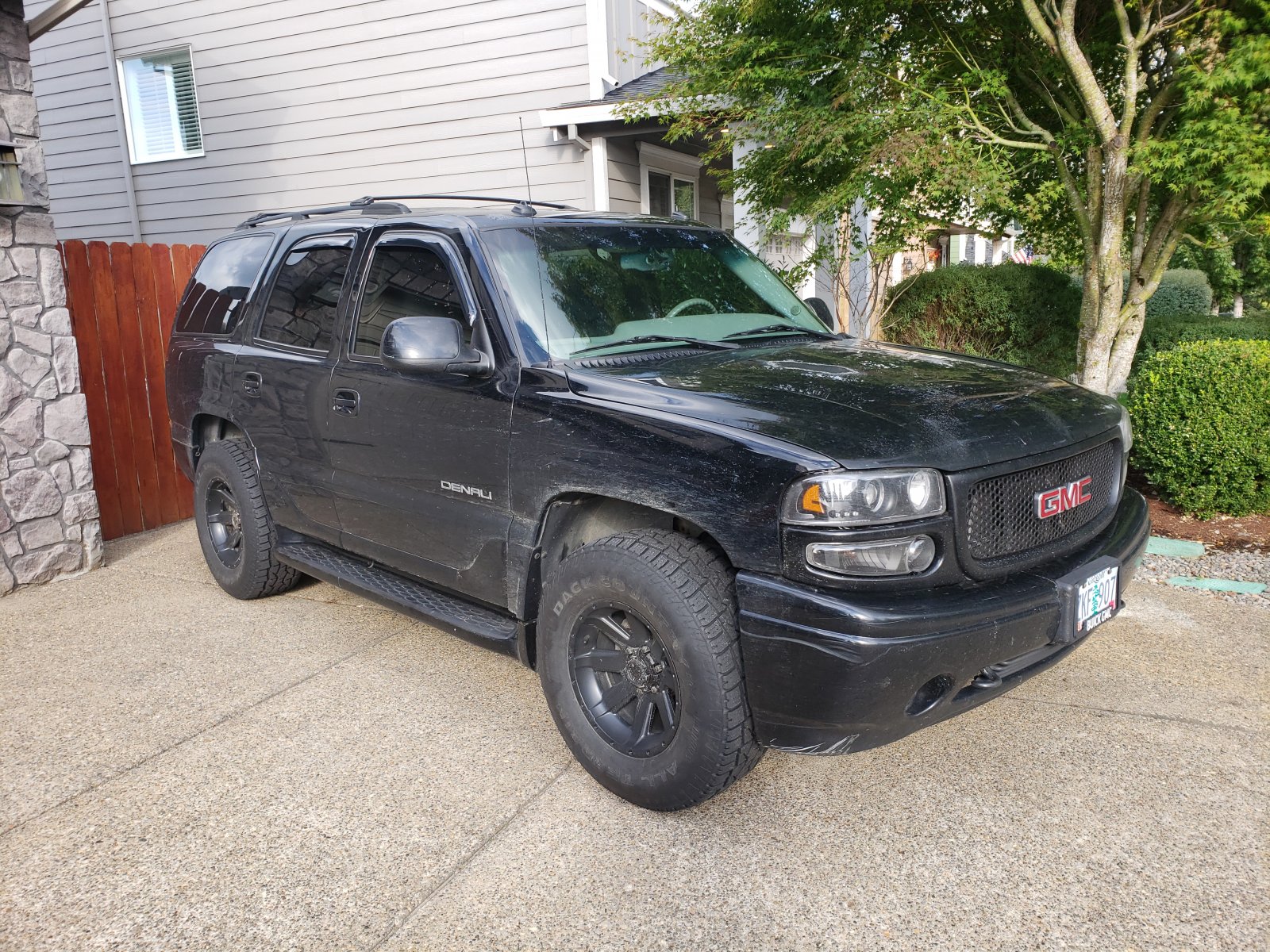

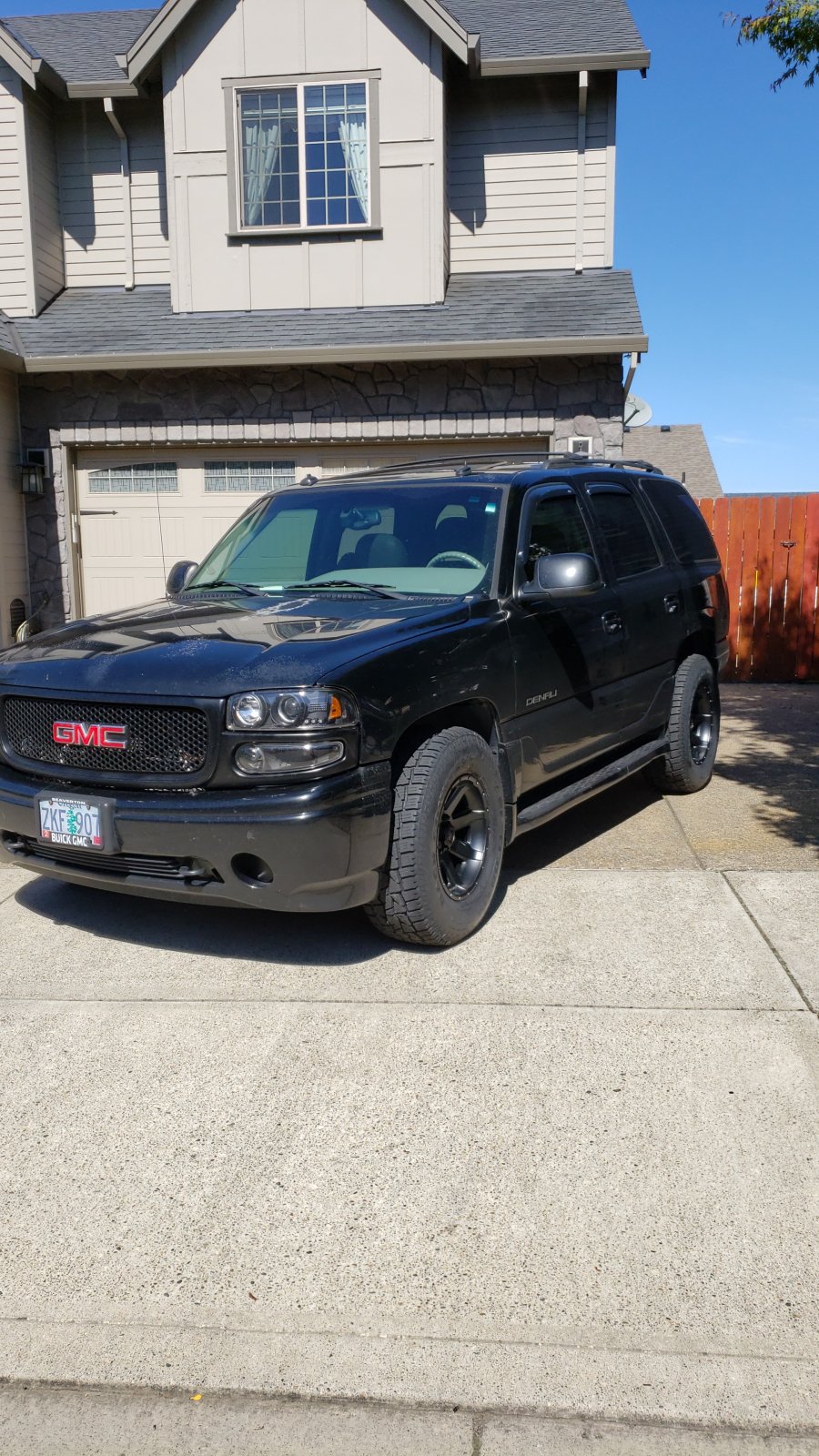

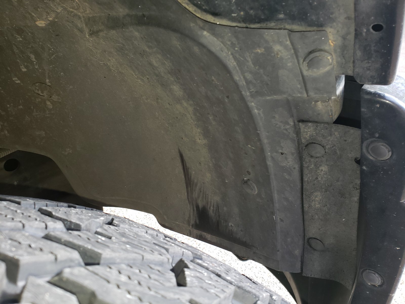

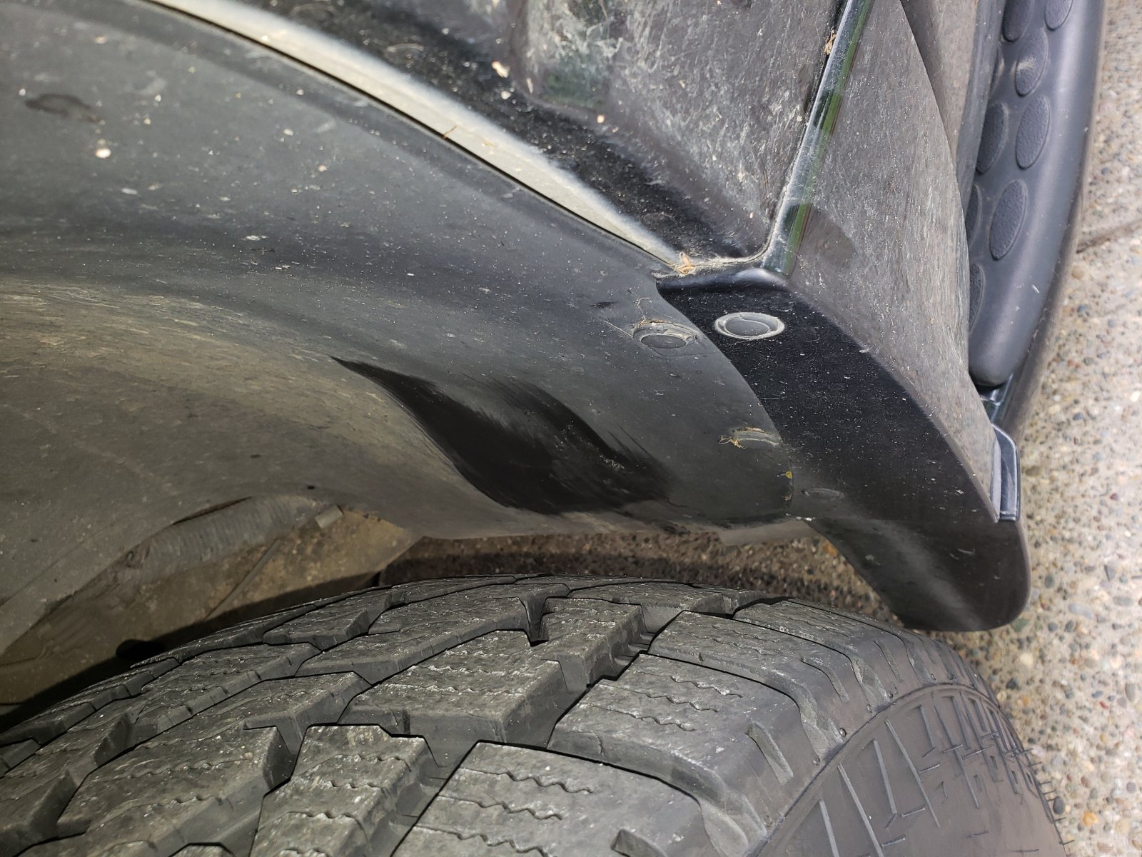

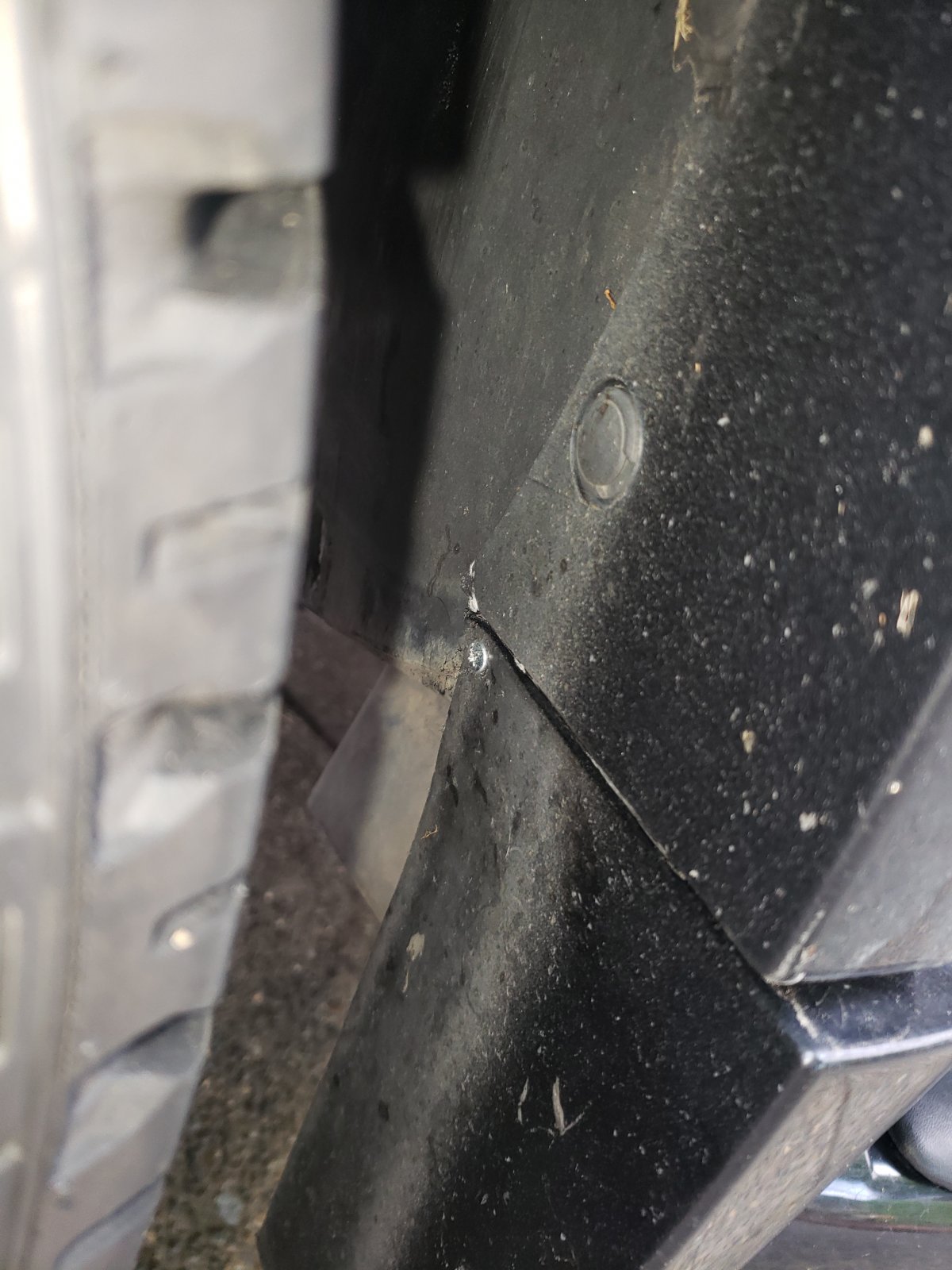

Hey everyone in Chase! I got my bone stock Yukon Denali about a year and a half ago from a gmc dealership with good records, regular maintenance and in very good condition. First thing I did was audio. Recently I've been getting into offroading though. Only light stuff but I would like to hit some trails. I got 285 all terrain tires with some black wheels, i read that they wouldnt rub, and they rubbed bad in reverse turning. Ive done a bunch of research but can't really find much info on the suspension and AWD system, and I'm no mechanic, but I always heard it's basically not possible/stupid to modify. But I'm stubborn, and I love my truck so I got the rough country 2 inch level tortion lift. with new front shocks. I think. It rides perfect, sits taller, and the tires don't rub. Only downside is when I floor it, it wobbles really hard. like really hard. I can still get up and go real quick, it's only when I really floor it. But I shouldn't drive like that anyways lmao, so I shouldnt complain. So I have a few questions, anyone out there with the same model? Anyone know about the AWD capability offroad? And does anyone in the Portland area want to hit some trails sometime?

Do you still have it ? Curious on the pix with the lift. I too want to get 285/70r17 but a little worried about rubbing. I eventually want to lift it around 2”
pshhh of course! and after the lift i dont think i was rubbing anymore, but it may be partly due to the extreme wear on the tires from whatever the issue is, that im still having to this day. i ended up going stock tires after moving to florida. it was pretty much flat on the left on the outside fronts not bad on the outside fronts and the rears had plenty of life left. its mainly the front left.
ive had it looked at by multiple places it seems like they fix it then after a day or two its messed up again. curious about what you did! and yeah heres some pics sorry its a little late!
