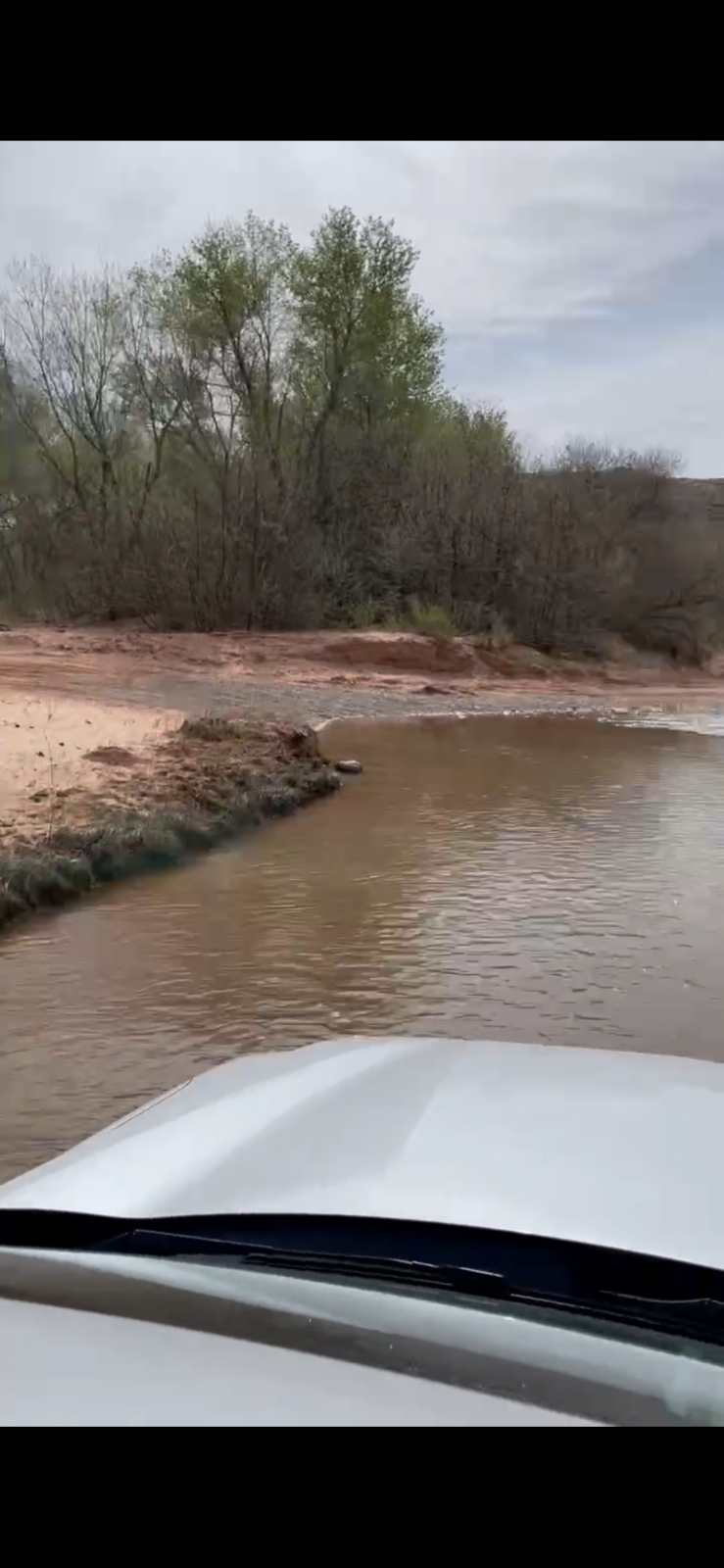

I have used 4L in powdery sand to keep transmission temperatures down, on rough forest service roads to keep from riding the brakes and in situations I wanted maximum traction, like water crossings. 4L is the only time you can use the +2 inch setting on the air suspension.
