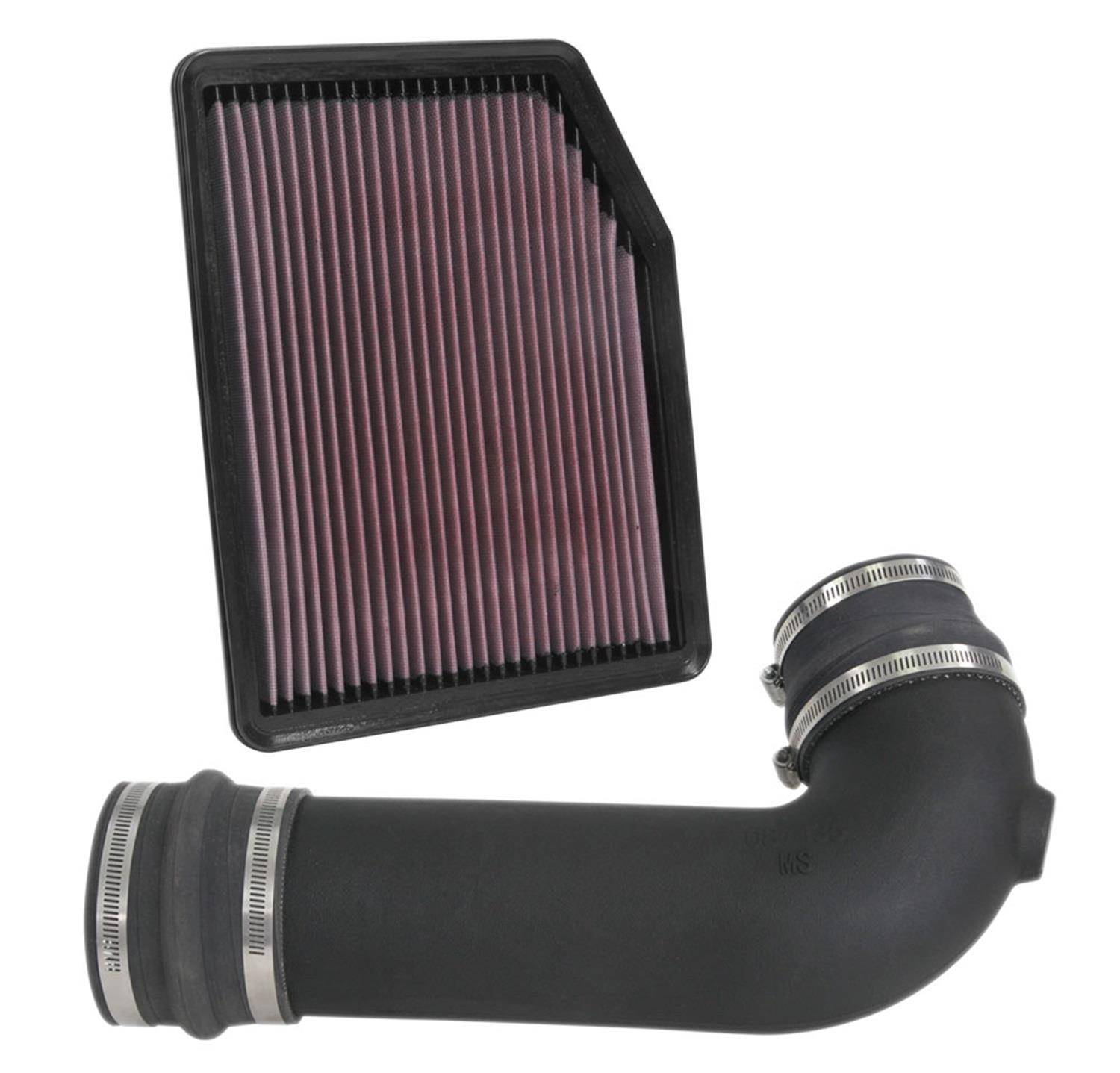

Hello! I did not see much, if any information on folks installing these, so I just wanted to share that I successfully installed a Cold Air Inductions Intake on my 2025 Tahoe 6.2. It was just as simple as you would think. For the current discounted price ($399) you get a great kit that goes together very nicely. The filter itself is HUGE. It's not your typical "cone" style filter, but has an angular, and oblong shape. The housing is simple and easily mounts right to the bottom of the existing air filter box. The entire install took me 25 minutes, and I really took my time. Aesthetically, it really cleans up the engine bay. It's a very clean looking kit. I was debating on this or the Rotofab, but i really prefer the looks of the CAI. As far as performance goes it's too early to tell if I've gained any MPG's per their claim, but I did have some fun n the test drive! The sound under load (especially WOT) is nice. Not too loud, but just audible enough to sound like the sweet V8 it is. I don't have a performance exhaust and am not sure if I want one. I like the comfort of this vehicle and I'd like to avoid any drone...especially the wonky drone in V4 mode!View attachment 452123 View attachment 452124
Very clean setup and nice product. I installed a C.A.I. intake on my Camaro ZL1 and I loved it.
