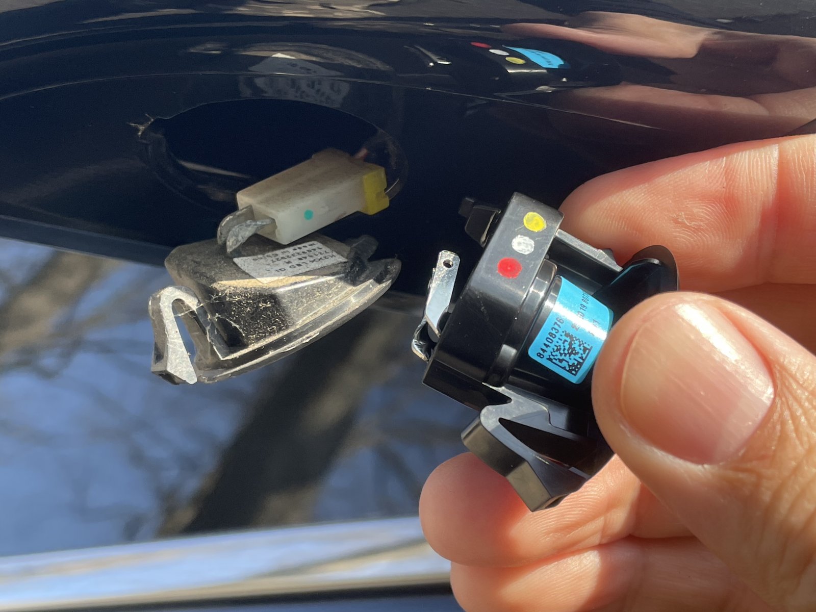

So I just installed these. Will recommend (very carefully) dremeling four points, three of which are captured in the pic below. First, the tab in front of the connector leads is too tall for our connector to fit so I took that down maybe 1/8”, as opposed to bending the tabs upward. Then the two (and one on the other side) other plastic beams on top of the circle. Take those down just a tad and the light assembly pops right in with no pressure or protrusion.
The logo still is at an angle which I don’t like but that will be easily remedied by dremeling a notch in the housing about 1/8 turn from the factory notch. I didn’t do that because I’m going to do the Esky mirror swap in the next few weeks and I don’t feel like doing the notch project twice. Hope this helps.
