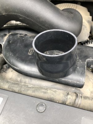

So I messed up with the coupler I bought . It’s to long and hits the fan cover . So my stupid error and we are in process of buying another car so busy here lol

You won't find a reducer any shorter than that. What I did on mine was cut a piece off the end of the 4" coupler and put that on the 4" tube so that tube was now a 4 1/2" tube, then I used a 4 1/2" straight coupler so the whole thing was shorter than using a reducer. It's kind of like using a spacer if that makes sense. Edit: you can cut it, use a good utility knife with a new blade.

You think it would work on the throttle body ?

I cut an end off the 4" coupler that was about 2" or so wide, then put that piece on the tube. Then the 4 1/2" coupler slipped over that so there was 2 layers of coupler. You just make sure it all stays lined up as you tighten the clamp.
