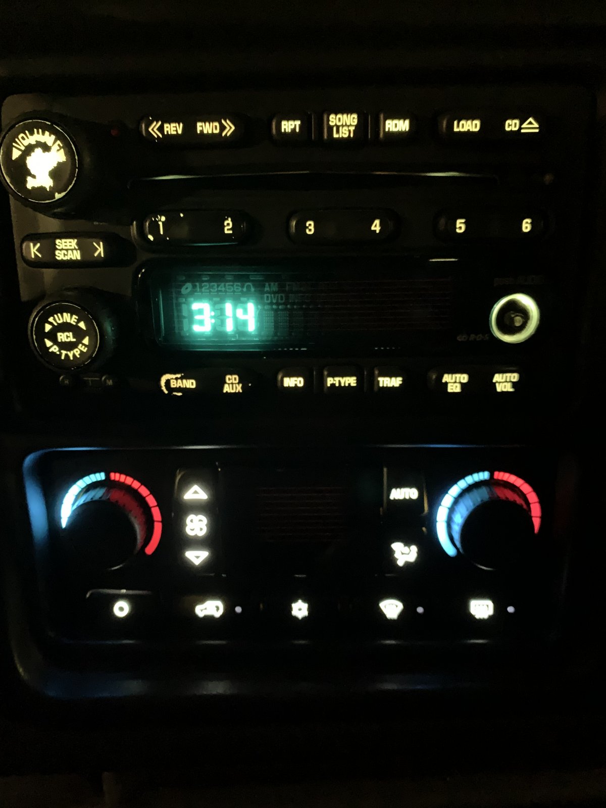

I needed to replace my A/C control head because it died, the new one works great but either the bulb or the new control head has a different color compared to the rest of the truck. The new A/C head has more of a new LED look. The color difference in the picture doesn’t quite do a justice... it doesn’t look great in person. Any ideas on how to make the lighting match the other dashboard controls?

Definitely looks like it has been LED swapped. I think your only options to make it match are to swap the rest of the gauges for LEDs or swap out the LEDs for incandescents. Either way requires desoldering and soldering new bulbs in.
