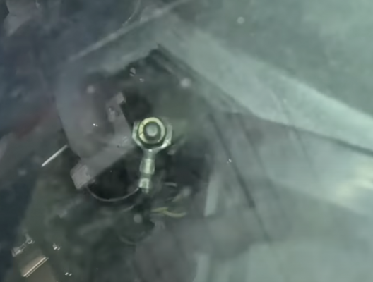

Can you tell me how to access the ground in the dash you're talking about? Remove the top dash cover?
I seem to remember accessing the upper ground by removing the a pillar trim from the driver side and it was accessible straight down near the base of the windshield. Im not 100% on that, might need to pull the upper dash cover out a bit. but something tells me it's accessible right in that opening. or it may have been accessible from removing the cluster and reach through an opening in the cavity behind the cluster. let me see if I got pics of it when we were working on it.
