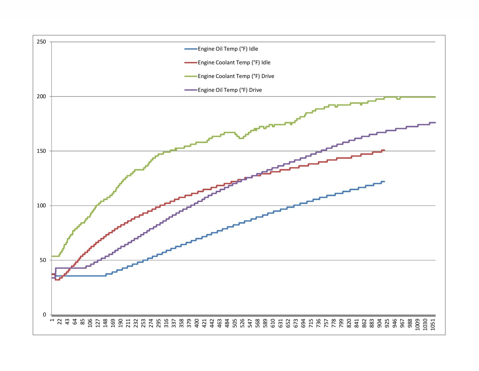

Best thing you can do is do not take short 15 minute trips, depending on the outside ambient temp the engine oil in these engines can take up to 30 minutes to match the engine temperature.
Even a 4-8 mile vehicle will have fuel in the oil. Pull the dipstick and check and smell for yourself.
I would try to get the vehicle on the highway for a 45 minute drive to fully warm the engine oil.
If you are getting a 6.2l run Premium fuel in it.
