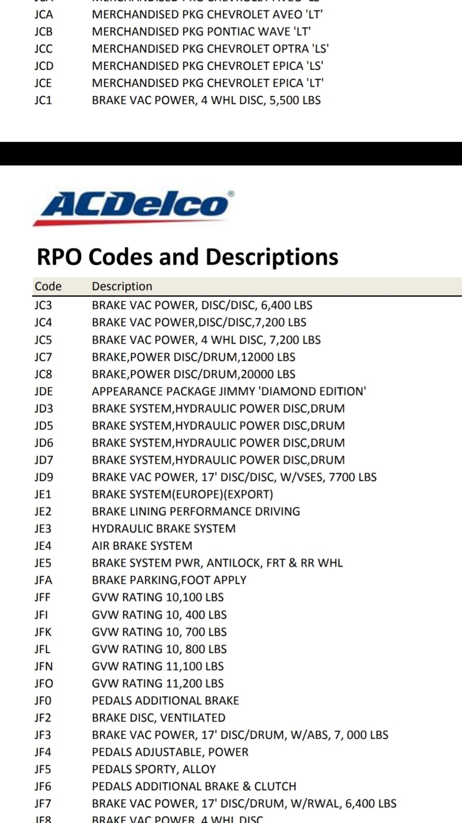

Standard on all SUVs in 2007+.
Not sure about the missing JL4. I do know that JL4 means you will have 6 flex lines instead of 5. There will be two coming over the rear axle instead of one.
Here are my codes for my 2007 Yukon XL SLT, all the literature says Stabilitrak, just dont see the code, no big deal I suppose.
20,307
27,878
Mine shows both JD9 and JL4. Sometimes they combine features and reuse an RPO number. When hunting for mine, we were looking for JL1 and JF4.
