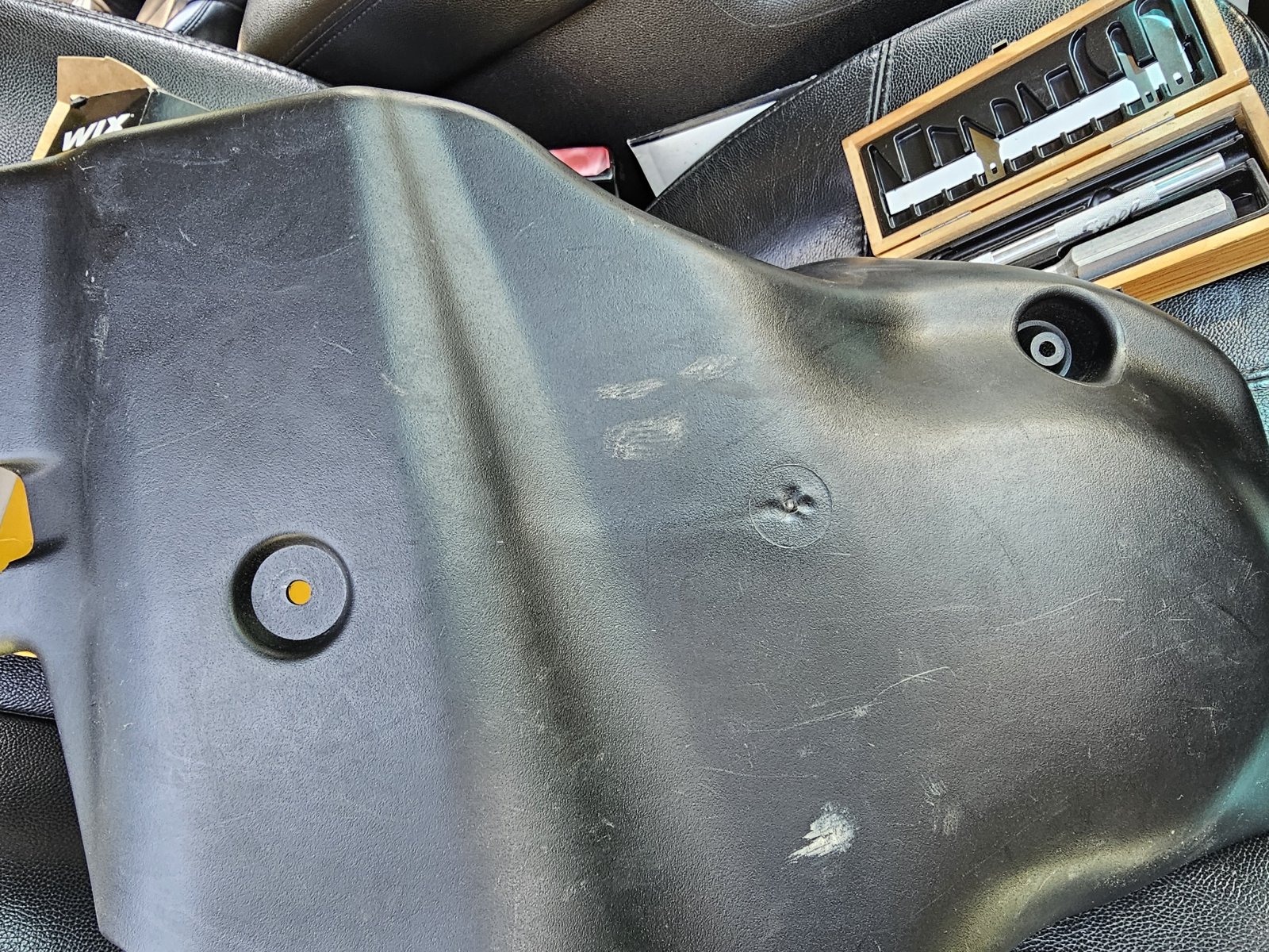

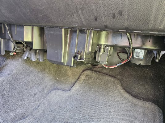

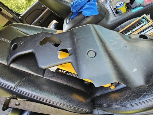

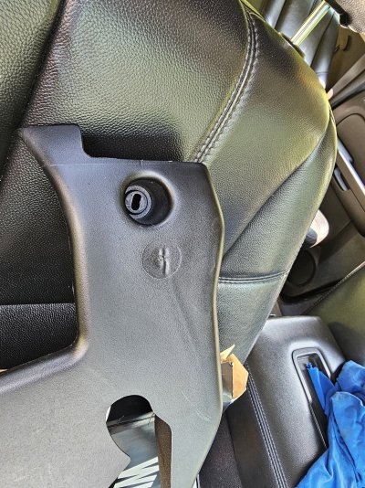

I just completed the conversion, and it took about 2 hours and one bloody knuckle.
I used a Dremel with a cutting wheel and a right angle adapter to cut about 60% of the slot out. Then, I used a fine tooth hacksaw blade to cut the other 30% of the slot out, where I did not have sufficient clearance to use the Dremel. Last, I used a utility knife with a new heavy duty blade to cut the two end sections of the slot out.
Overall, one of the easier mods on this truck.
