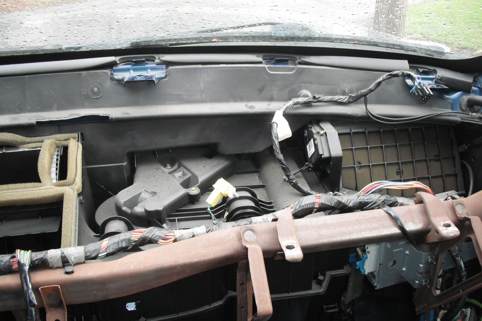

Yes, the front and rear have their own separate systems. The rear is located behind the passenger side rear compartment. There’s a separate heater and ac unit there, with its own blend door and mode door with corresponding actuators. Up front there’s 4 actuators- blend doors for passenger and driver temp control, mode door to tell the air which vent to blow out of, and recirc door to tell the system to either draw outside air in or to recirculate the inside air. The recirc is the hard one on the NBS. I replaced mine in a couple hours by only removing the dash cover and then removing enough screws from the supporting structure that I could pry it up enough to get to it.
So in total that’s 6 actuators.
