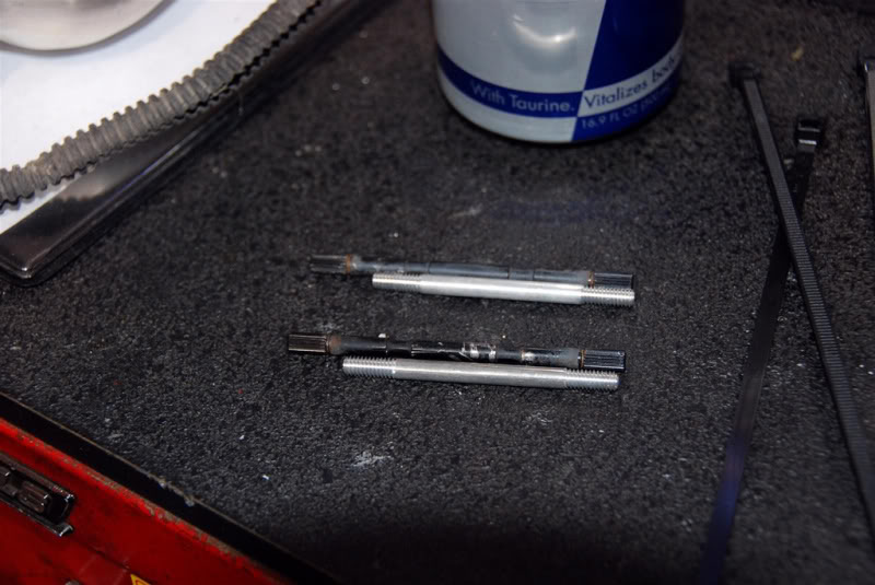

I have some of the shorter links to trick the Autoride if you want them, free, if that's the kit you go with.

They come with the belltech kits, but I'm sure I can fabricate some and ship em out to anyone. I just bought a huge rod of threaded grade 8 steel the same diameter of the stock links and cut them down for my truck.
WHAT SIZE all thread is that? Looks like 1/4" NPT...and also what tpi (thread per inch) 20(course) or 28(fine), if it's 1/4" NPT.
