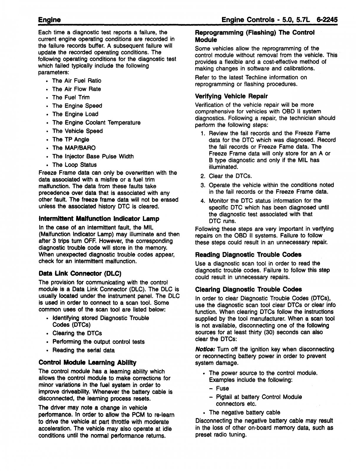

Do these generation computers have a relearn period after doing a reset that you know of?
26,036
38,884
I lay right over the engine compartment like Superman lol. My chest is still paying for it. The problem resolved itself after that first stop sign. Vacuum leak? Didn’t think of that.
been a while since I had a obs but I would say evap and 02/cat system, maybe egr system also will have to self test a few cycles, shouldn't matter unless you are trying to get it inspected in the very near future

There is a drive cycle completion due whenever power is removed. I havn't seen it required after code clearing. Hope this helps you.
