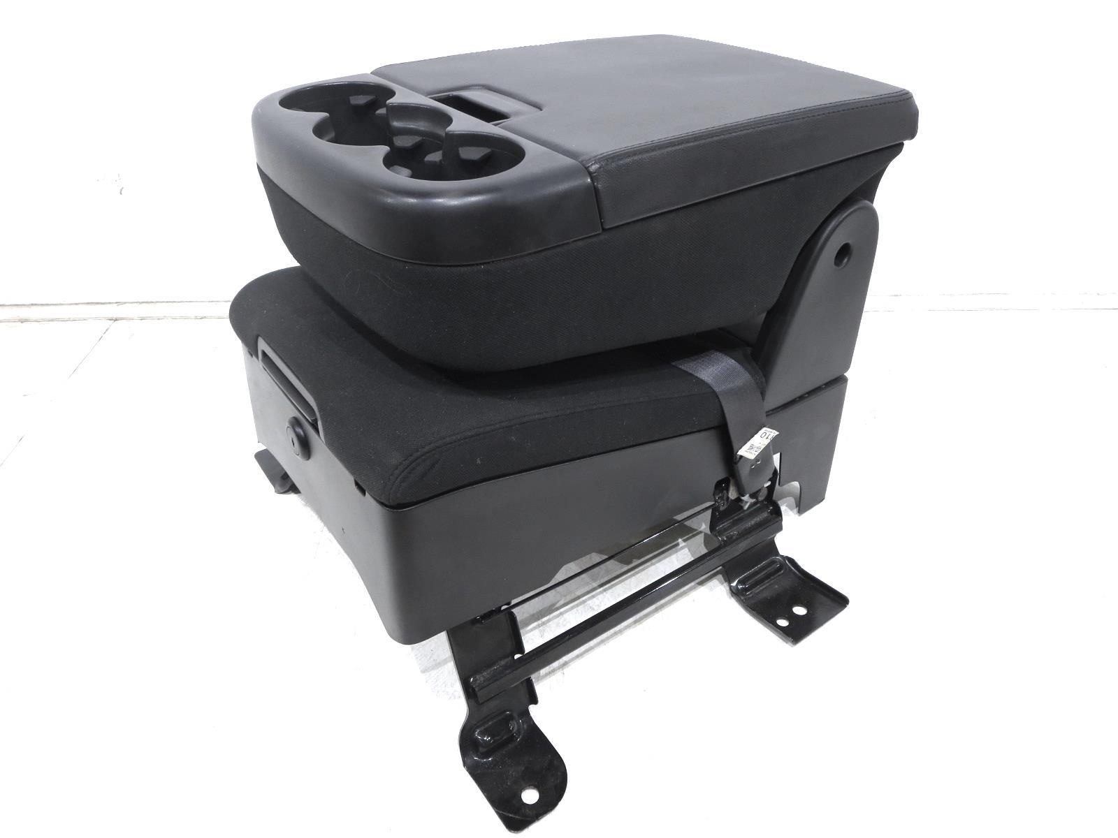

Ok...but the first post shows a black jump seat, but then this pic shows a grey jump seat that matches your interior. Which one do you have, because the black one has the normal mounting brackets that attach at the seat bolts.

I have the last picture Of my actual interior The generic pic from the beginning was incorrect

Oh ok. We need to see the actual jump seat turned upside down so the brackets (or lack of) are visible.

Looks like you have the jumpseat off the 15+ Tahoe. Mine looked like the first pic you posted from ebay. Thats probably why its not bolting up correctly

If it is the 15+ model jumpseat any suggestions ?

I dont think the brackets are removable on yhe nnbs jumpseat..when i sold mine last year it was a pain to ship it via fedex cause i couldnt find a big enough box to ship it. Ended up cutting a box down to make it fit with the bracket sticking out

My 2010 had a 2015+ for a while. Some bent sheet metal to mimic the 07-14 style welded to it worked like a charm.
