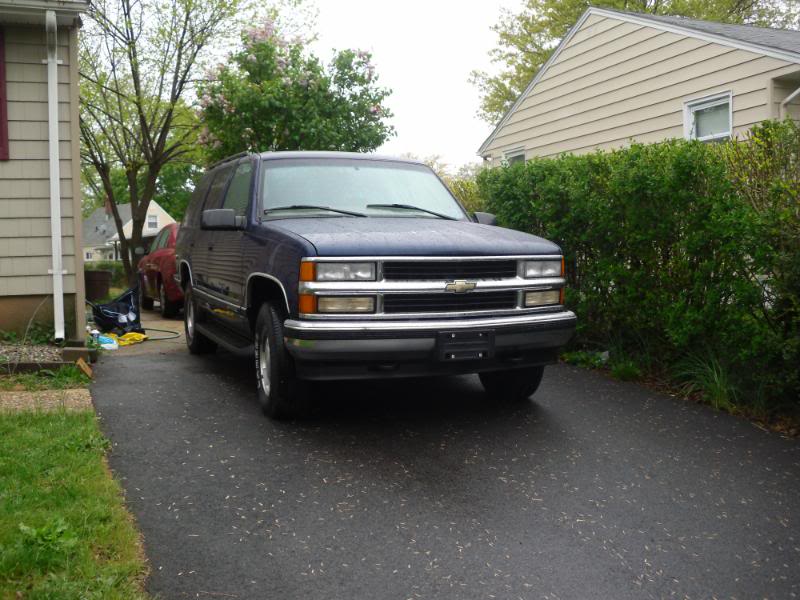

Got any pics? $4700 isn't a bad price especially since those are decently low miles for a '99. Mine came with 135k. I don't blame you for being pissed though, I would be too if the seller didn't mention any of that stuff.

Took some pics, although it has to be rain here in Jersey.
